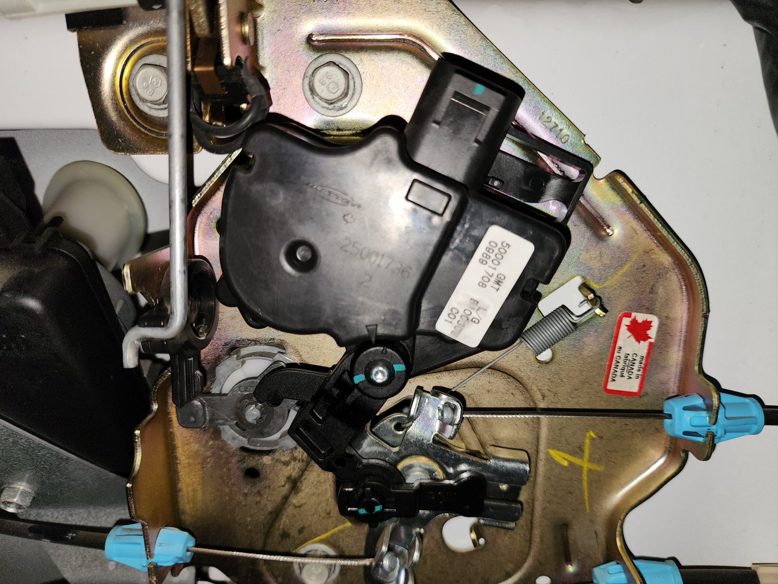

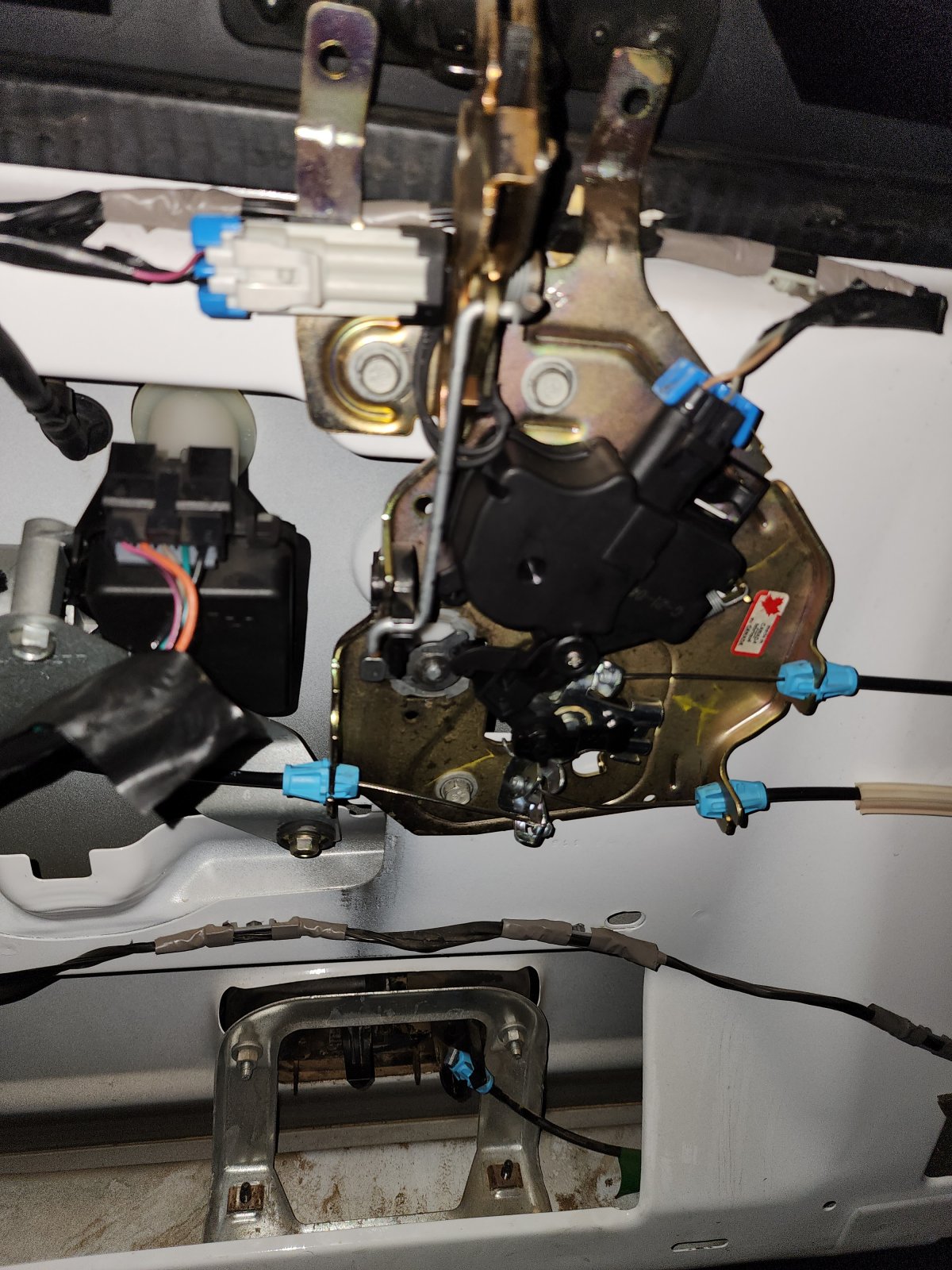

I'm gonna add a question... this thread was a life saver... I have an 05 Tahoe PPV. Replaced the tailgate actuator... the glass will unlock and lift but I replaced the exterior handle and hooked the cables up... now will not unlock and dead like beginning... any thoughts?
