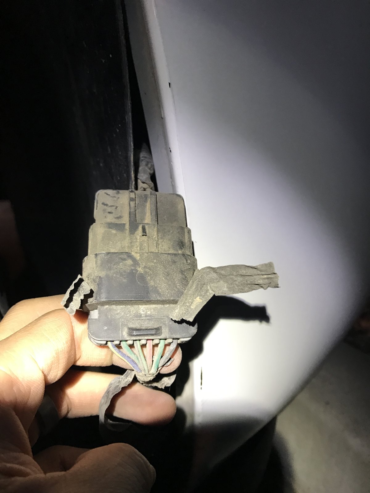

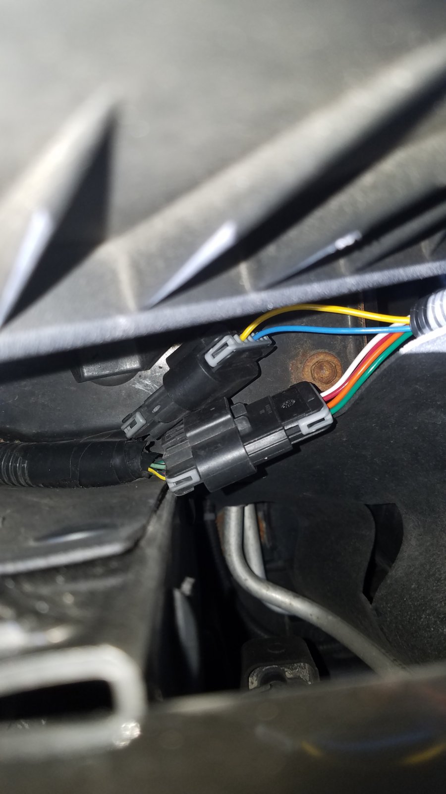

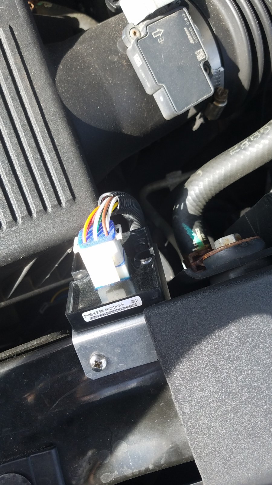

So first for the flasher to even work, there actually needs to be a module connected. You can check by looking behind the flap in the passenger side front wheel well near the bumper. There should be a wiring harness with two connectors there, if they're connected together then the flasher system will not work, if they're connected to a small black box then it will work. All you have to do is apply 12V positive to the dark green/red wire.
