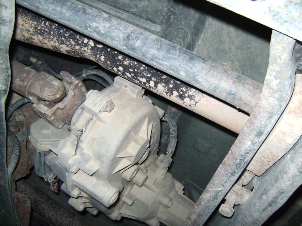

pics of how the exhause is routed under the truck? im going to redo mine soon. i want longs. how do those headers fit?

ya its a 4wd, i had to get the exhaust tube bent about 2" toward the driver side of the car to get it around the transfer case... other than that though there were no fitment issues, but it could be due to the body lift. other people have a hard time fitting long tubes?
ill get pics of it up tonight, couldnt get a good view with the cell so ill have to use my camera

thanks man. ive got body lift too so maybe they wull be easier to install. i might get the duals running down the pasenger side since i got the fuel tank on the drivers side

Nice work! It's weird you had to put that bend in there before the transfer case, same headers and when they ran mine it was straight until it makes the 1st turn to go under the tailhousing. :think:
The pic makes it look tighter than it actually is, I've got a 3" or more by the transfer case
