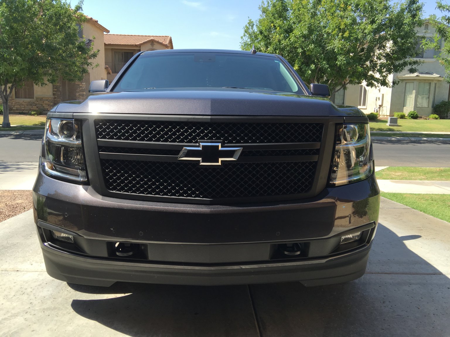

If you have any pictures of the front, after or during the install I'd love to see them.
Thanks.

I don't have any photos from during the install but can upload some after shots. Will try to do so a bit later today.

That looks great. Thanks for the picture. Did you have to pull off the entire bumper to install the hooks and facia?
Did your original facia have what looked like cutouts for the tow hooks? Mine do, and it seems weird they would have the outline for the cut even though it's a different part number for one with the space for the hooks.
Thanks again, I feel better knowing I have the right part number even if the pic from GM doesn't match.
You're welcome.
I did not pull off the entire bumper to install the hooks and fascia. However, because I didn't I did end up breaking a couple of clips on each side by the eyebrows. You can't really tell that they are broken though.
Yes, the original fascia did have what looked like cutouts and I had originally actually cut those out to do the install of the two hooks but it looked terrible and it left some of the wiring exposed so I ordered the proper fascia part to go along with it and it looks a million times better.
