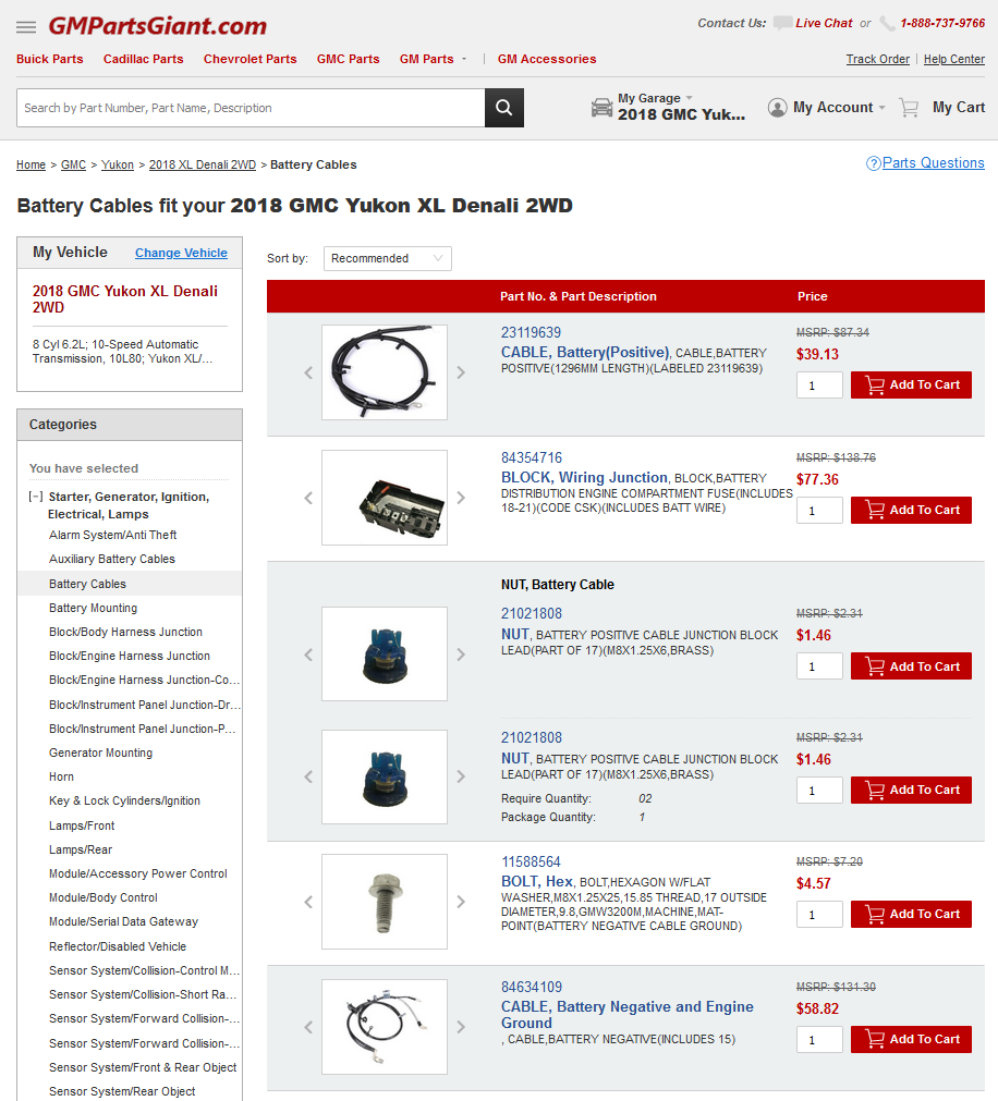

Finally back in town to put a new battery in the wife's 2018 Yukon XL Denali. Was thinking it might be a good idea to replace the cables while I'm at it. It is my understanding the negative cable can cause weird electrical gremlins as it degrades. I looked on GM Parts Direct and can't figure out which cables I need. Before I walk into the dealership and try to sort it out with the counter jockey, does anyone know the part numbers I need? Thanks.

The listing for yours is here (first and last items shown). Enter your VIN and search if it's not what you think it should be; Rock Auto lists one for the dual battery setup. 4wd was the same for cables:

Thanks for the link with the correct cables Fless. I just ordered them from Rock Auto for a couple dollars cheaper than the link you provided. They will be here Friday and I will see how joyous it is to swap them out this upcoming weekend.
