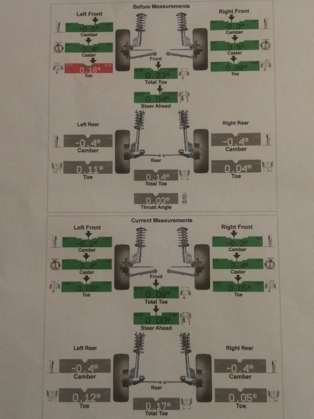

Right on well I'm glad it has fixed the problem you had. I'm still chasing a bump steer problem. I have had the suv to 3 different shops including an alignment and they all tell me everything is tight and in spec. But yet the steering wheel still shakes over bumps...
