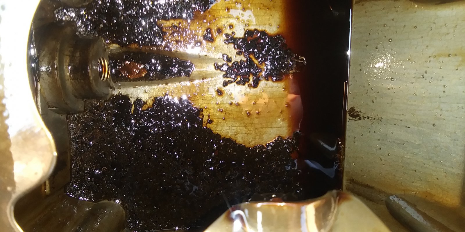

Brandon1320
Jul 15, 2021
17
Georgia
So I was able to drop my oil pan and I'm pretty sure I found the source of the low oil pressure. The pick up tube screen was completely covered with gunk. The bottom of the oil pan was full of sludge. My pick up tube o-ring seemed in pretty good shape but obviously I replaced it anyway. Cleaned the tube. Cleaned the oil pan. Pulled the plate off the bottom of the engine below the crank and cleaned that. Clearly this engine didn't have the best maintenance. Put it all back together and now my oil pressure is back up and running good.
31,922
47,938
My van with the 4.8 was in the same condition. I also changed out my oil pump with a Melling hv unit.

Good results! Hopefully no issue down the road. Anything older than a 2007 shouldn’t have a screen in it anyway.
