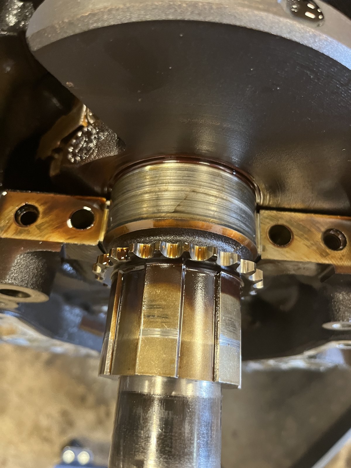

I changed my o-ring today, and it seemed like it fixed it for about a minute, then wobbled back down to 20psi. It was a black fel-pro o-ring, did you guys use the red one like I've seen on YouTube videos? I really don't wanna do it again I know that.

I had some sludge too, definitely more miles on this motor than the guy told me...

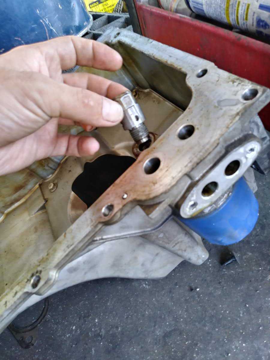

I used the red one when i did my truck. Was a super tight fit, but sealed good. Carries 40-45ish psi 60mph cruise, but will hit 70-80psi if wound up to pass. Also there is a pressure relief spring that can stick that i wish i knew about when i did mine... i would have cleaned that too.
Edit: these pressures are with 401,000 miles on the engine.
