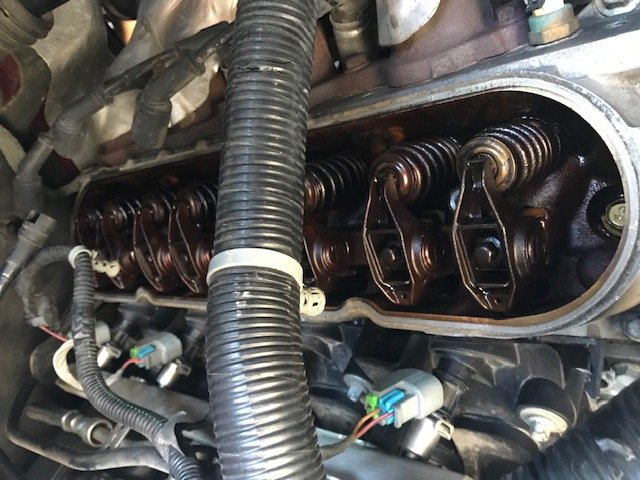

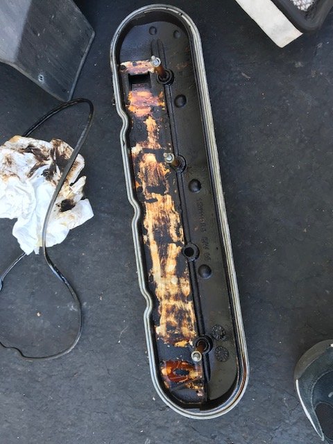

What was the reason for adding seafoam? Have you removed your oil fill and taken a peek inside the valve cover? If you have that much sludge, frankly, a mechanical cleaning is preferred.

Since you just changed the oil, it should be still be really translucent. Pull that oil pressure sensor and see if it has black junk in the hole. Otherwise it'd only have the fresh oil on it. Even though you drained the dirty/diluted oil from the pan, you still may have particles circulating through the system that have yet to get out. Watch the color of the new oil on the dipstick to see if it turns dark really quickly. If so, do another oil change to get that crud out. I hope you're using a good filter.
