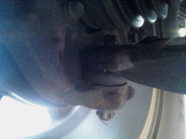

Ok, here is what I mean. With my 03, when you take the nut off the bottom, the spindle doesn't just fall down. The ball joint shaft is tapered. I tried 3 different kinds of pickle forks, but none of them were thick enough, or wide enough to separate the spindle from the shaft. It also didn't work to try the ball joint press around the entire spindle and control arm. So, I removed the rubber, wiped all the grease away so there was just a shaft between the control arm and spindle, and cut that shaft so the spindle would fall away from the control arm. Once that happened, I used the ball joint press on the control arm, then again on the spindle to get the little piece of shaft off. It was very easy after that. I used a grinder, I'm not sure a sawzall would work or not, I'm sure it'd hardened steel. It took less than 10 seconds to cut it with the grinder. Getting it pressed back on wasn't a problem.

Taking the control arm off isn't going to help when the shaft is pressed into the spindle too. How are you going to separate the spindle and control arm where the grease boot is?
