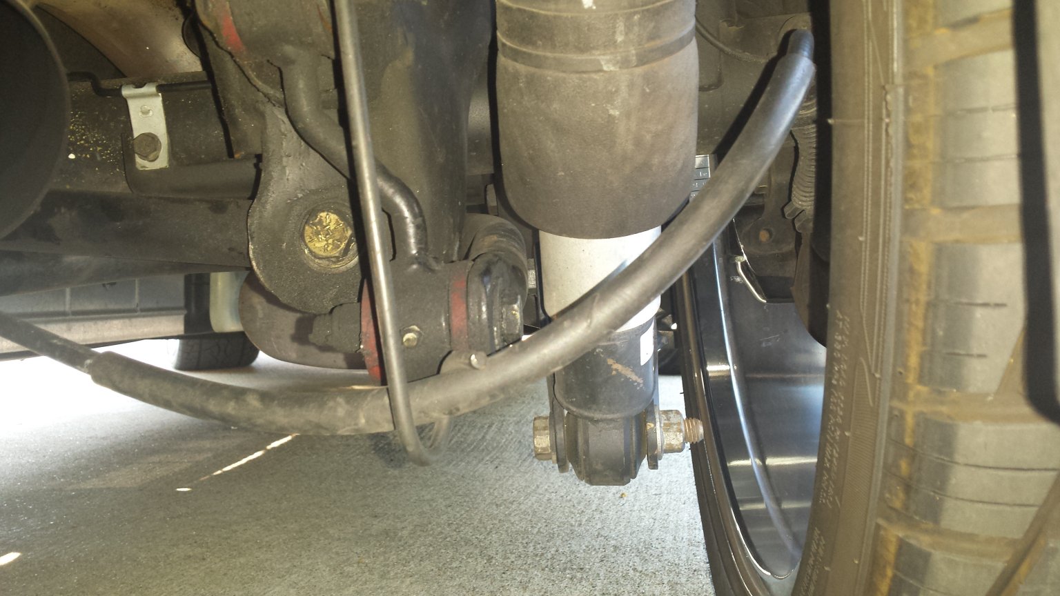

I wish I had some pictures NorCal of the stuff installed in the rear end. I have moved over piece in the back (sway bar (torsion) maybe)

Did you mount shocks facing up? Now on endlinks unloosen all 4 bolts so want come out and ride around block then torque them wuth full weight on them.
Also did you cut the entire bracket ie 12 inches about off the frame?
How much space between bumpstop on axle and frame in rear?

I had to laugh a little regarding the shock mounts, but yes they are right side up. :) Yes the free travel mod has been done and rear end is not hitting the frame.
It is just REALLY stiff and in the rear, there is no "clunking" sound it is just stiff and doesn't absorb a bump as it did before these mods. Just trying to "soften" the ride up before it makes me go buy something else. lol
