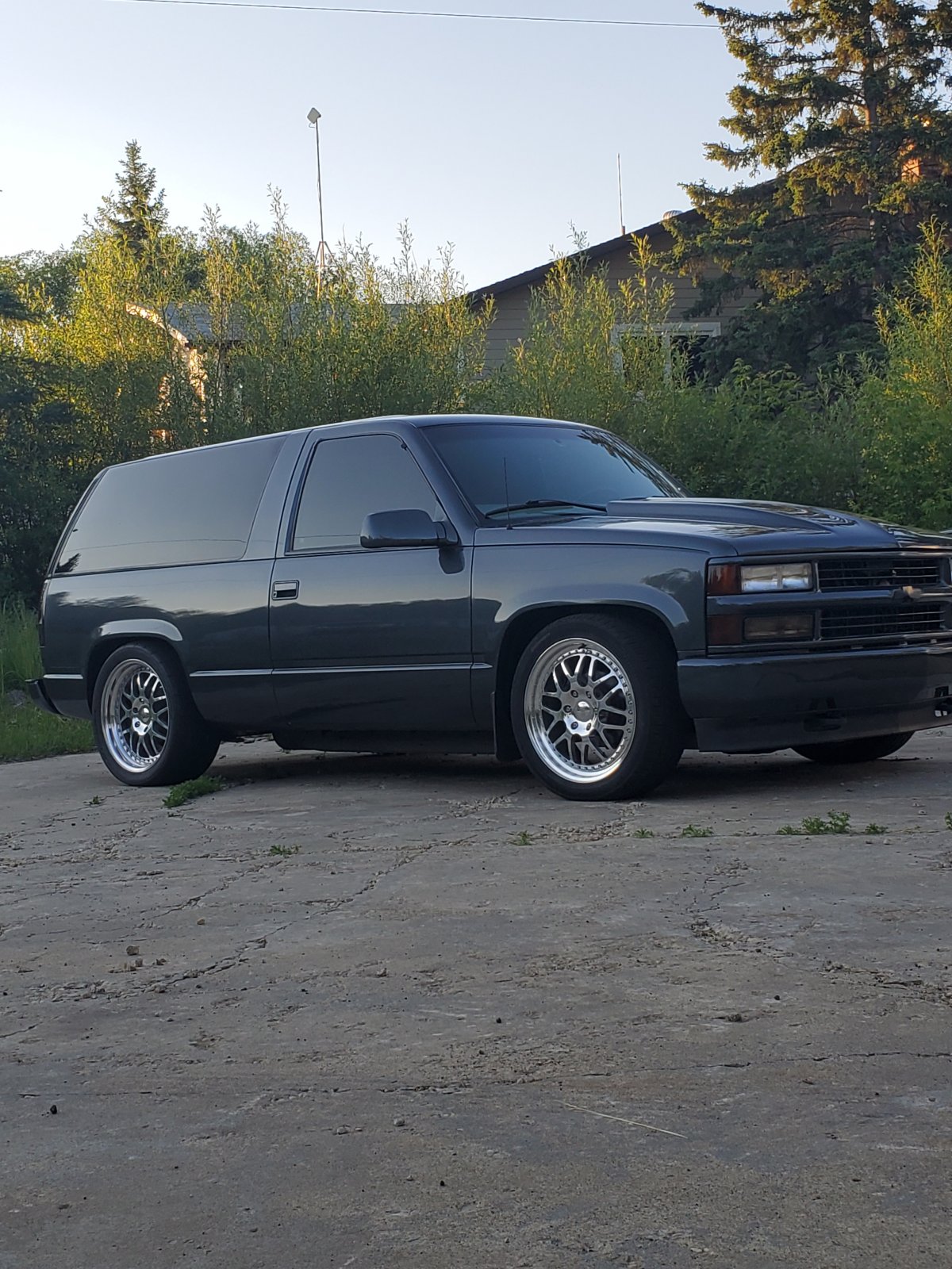

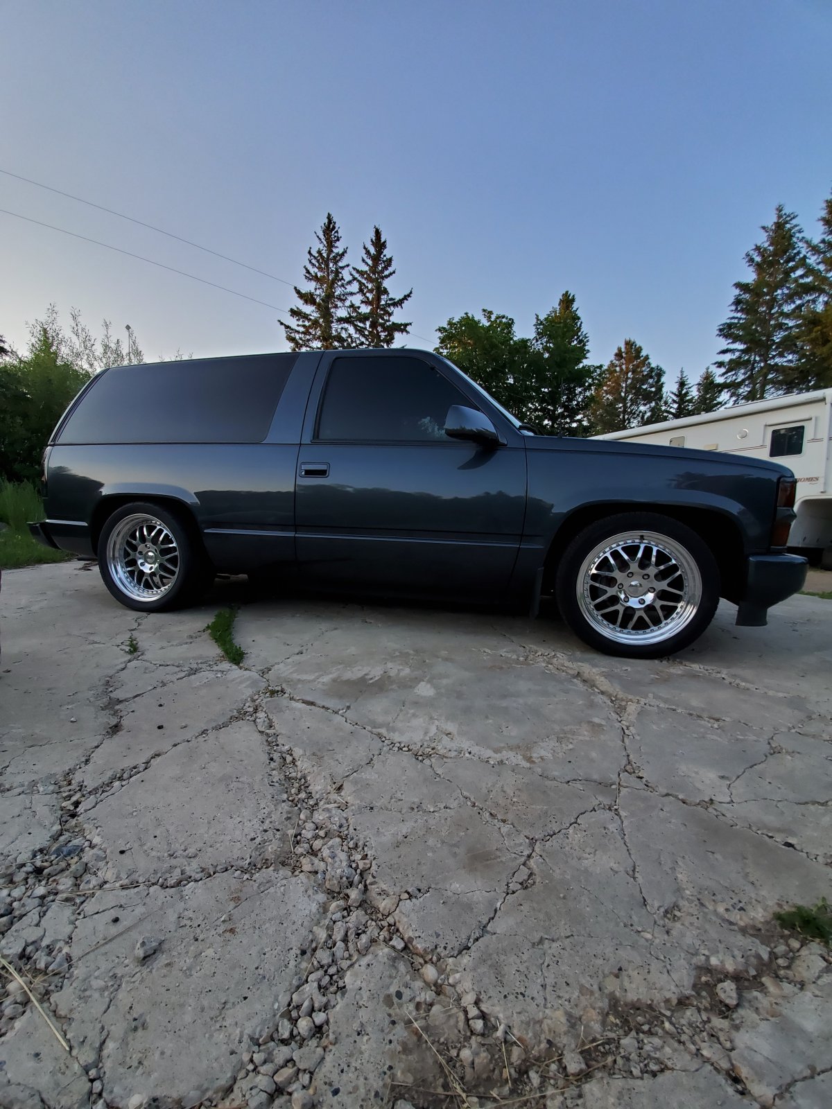

Never taken proper pics of the 99 Tahoe until today, so here y'all go.
It's a 4x4 with a rear belltech truck flip kit which works perfect for anyone reading this, you just can't use the notch so order without. In Canada I was looking at 500 bucks for a 2 door hoe flip kit, and I bought a 98 Silverado flip for 210 dollars full belltech, and it worked perfect.
Then front bump stops cut an inch from gone, belltech sp shocks all around, and belltech drop keys
Didnt measure to start, but it is for sure no doubt a solid 4/7 drop.
20x7.5 front wheel with 72mm positive offset running 255/40/20 front, and 305/35/20 rear.
It is in 20190616_204515.jpg 20190616_212757.jpg cyber grey.
