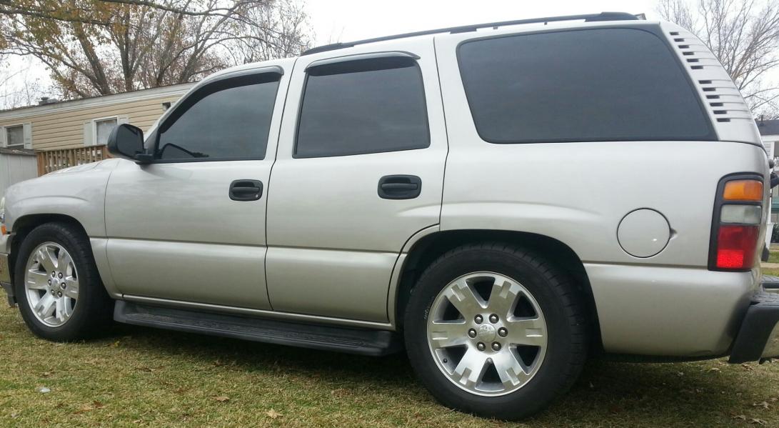

lowered my 04

So not happy with the stance, would like another 1" in the back so what r my options. Thanks

Few questions.
1) what rear springs are you using now?
2) did you do free travel mod needed for more than a 3 inch drop?
3) are you running shock extenders?
4) shorter shocks installed?
5) djm endlinks for swaybar?
Tell me that I can dial in a kit for you

the spring r bell tech spring
no on the free travel
yes on shock extenders
no on shorter shocks
no on the djm end links
thanks

Which bell tech spring?
5305 part number on them?

Not sure will have to look up what I bought.

You need to cut brackets off frame and do my bumps tops with dam links. It's 110 shipped and rear will come down more. If it's the 5305 and no spacers you probably are sitting on bumpsrops
