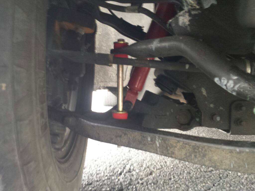

Hey guys new to the forum. I have a 04 Tahoe I lowered a couple weeks ago still need an alignment but looks like I have issue with tie rod hitting sway bar is this a common problem or something else. Truck has all new front suspension tie rods etc...20170112_115813.jpeg

Kit was given to me its street edge. From all the research they use belltech spindles and keys. Running 2 inch drop spindle and 1 inch lowering keys

Change your endlinks. It doesn't look parallel to the ground anyway and it should be. Energy Suspension has any length you need.
