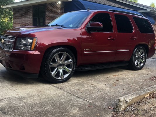

I have a 2/3 drop on my 2010 Tahoe and I’ve never liked how the rear takes bumps. I have the belltech kit and the street shocks and struts that came with it. Should I switch to some new rear shocks? If so, which do you recommend? Any other recommendations will be appreciated.

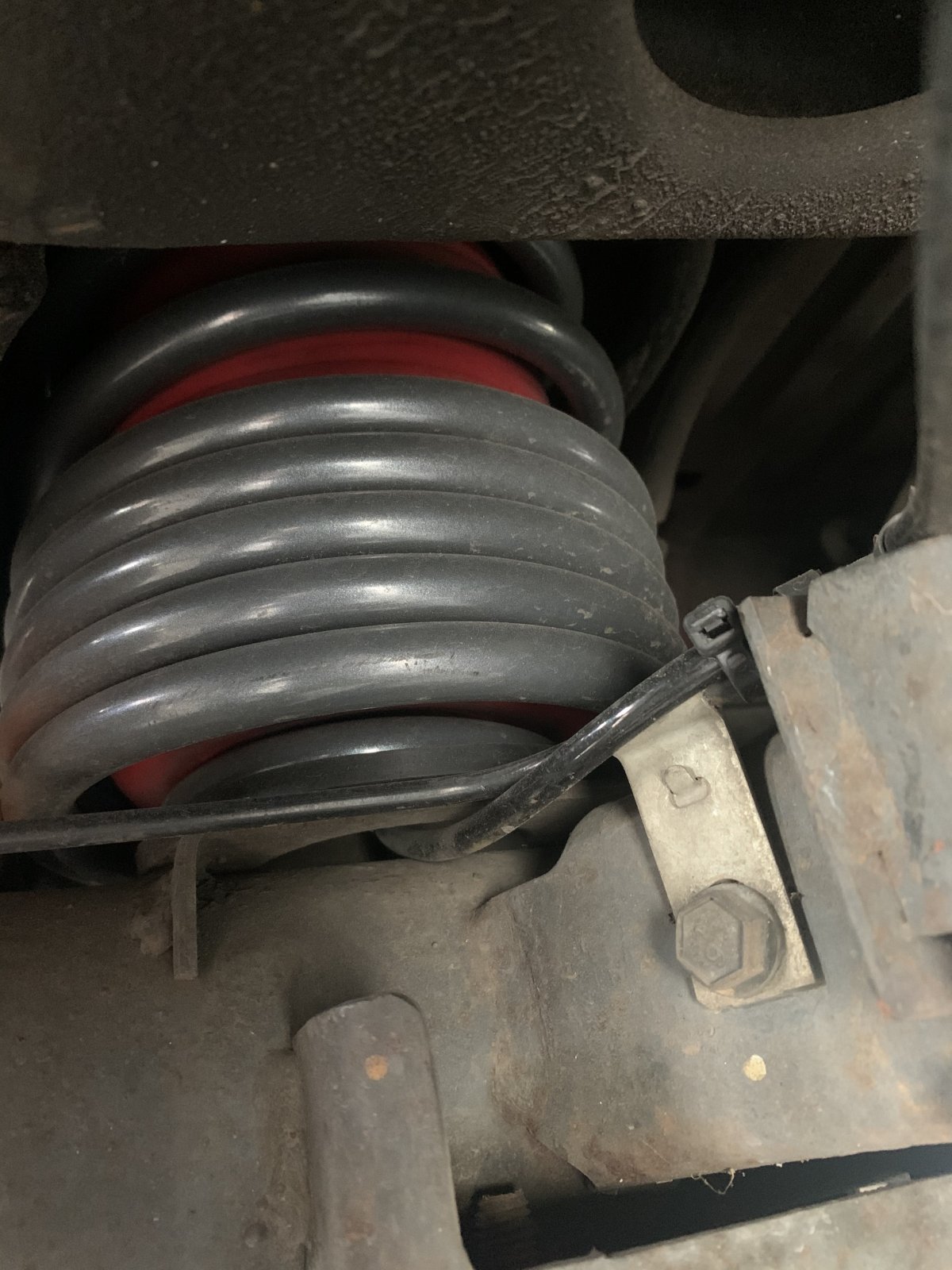

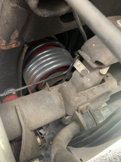

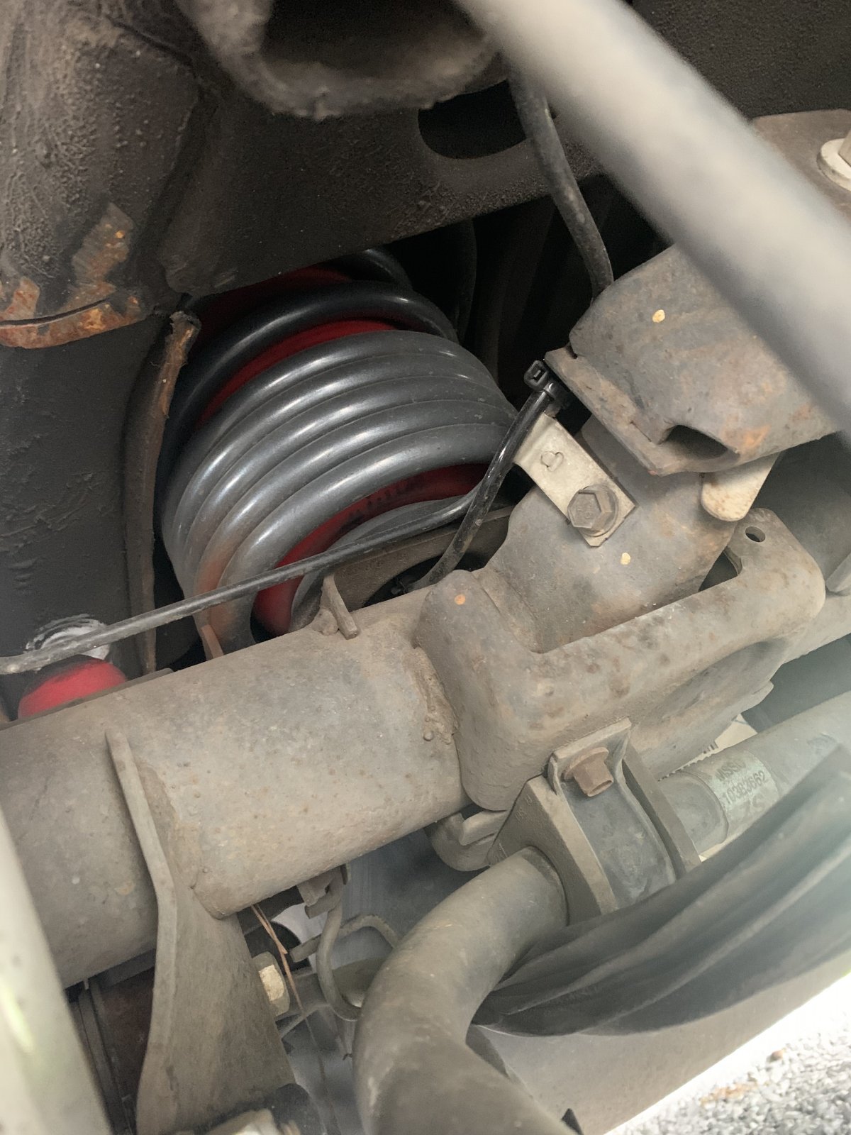

Yes it has the shock extenders. In my opinion, I think the springs are bottoming out. The shocks have plenty of travel left.

I kind of doubt it with a 3" drop. Do you have pictures of the springs with the truck on the ground so we can look for binding?
