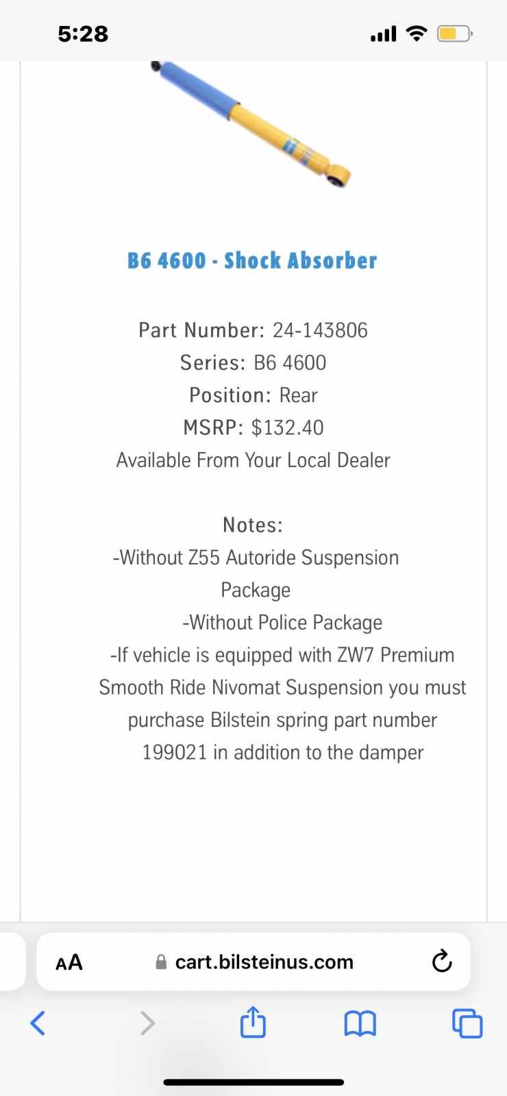

I have Bilstein 4600. ZW7 comes with the Nivomat shocks, which are really firm, so the springs are a little soft. You can't use non Nivomat shocks with the Nivomat springs, if you do then you'll be experiencing the exact conditions you're having now. Same thing happened to me until I used lowering springs. It was really scary driving on the highway. It was like someone was pushing it side to side in the back.
Ok so the bilstein 4600 would go good with the 4 inch lowering spring my Tahoe has in the rear ?

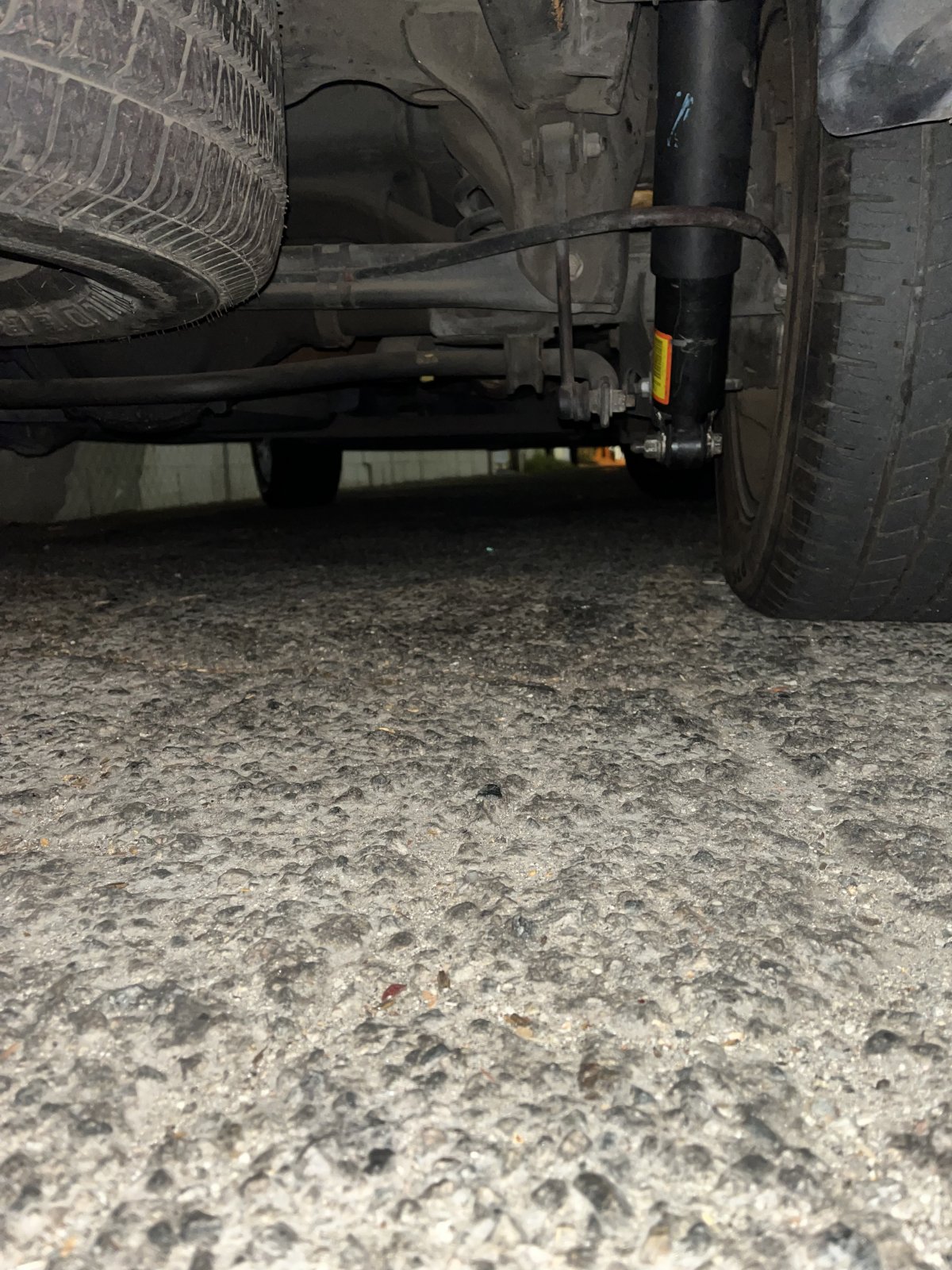

Thanks I took it to a shop and was told that my sway bar needs to be parallel to the floor and mine at the moment is towards the floor
Getting shorter end links in the rear to level the bar would increase its effectiveness. How about the front? That's where the rear story lies when it comes to excessive sway. But, also with the rear, the springs could be too soft. When driving straight and you hit a bump, does the rear feel cushy?

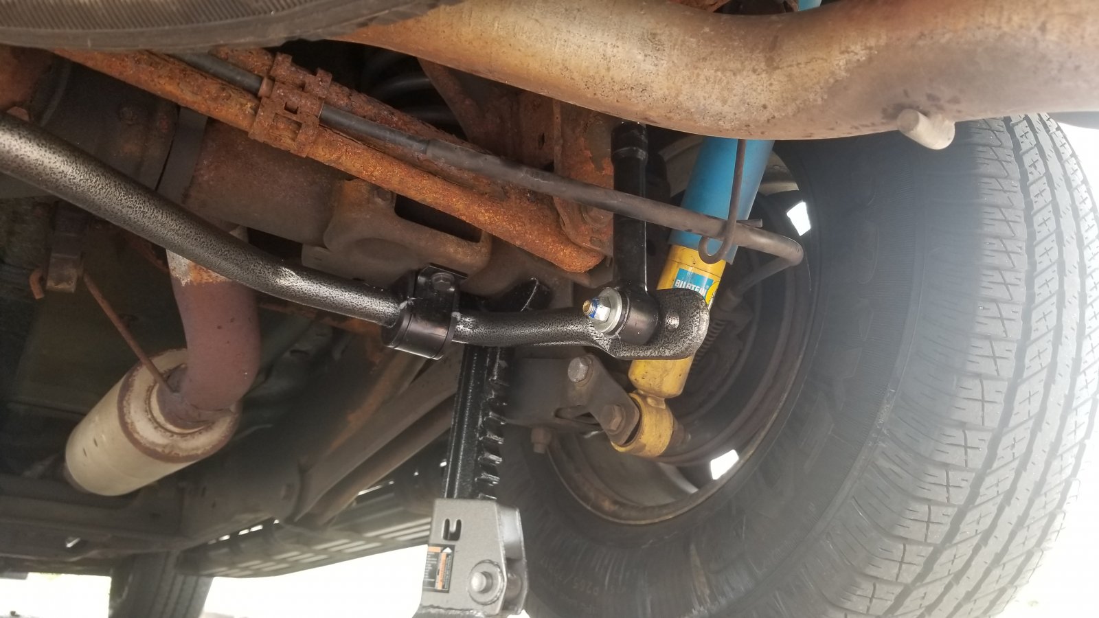

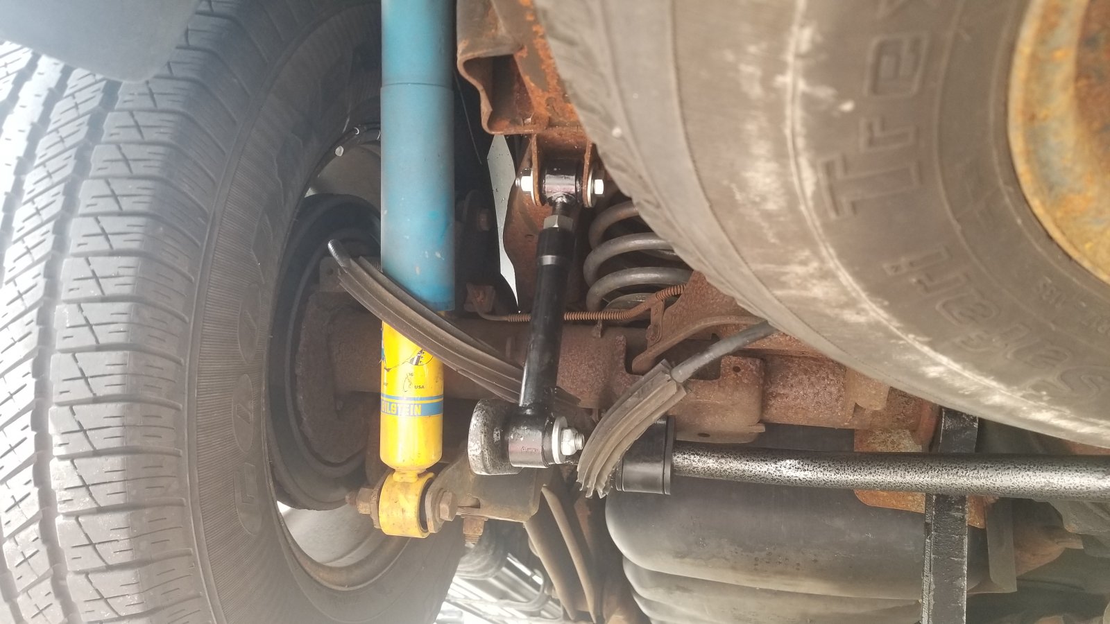

Worked on my 3" drop. Make sure you use the drop brackets for the shocks.
I appreciate it , im going to look into those bilsteins . Did you use the shorter rear sway bar links as well ?

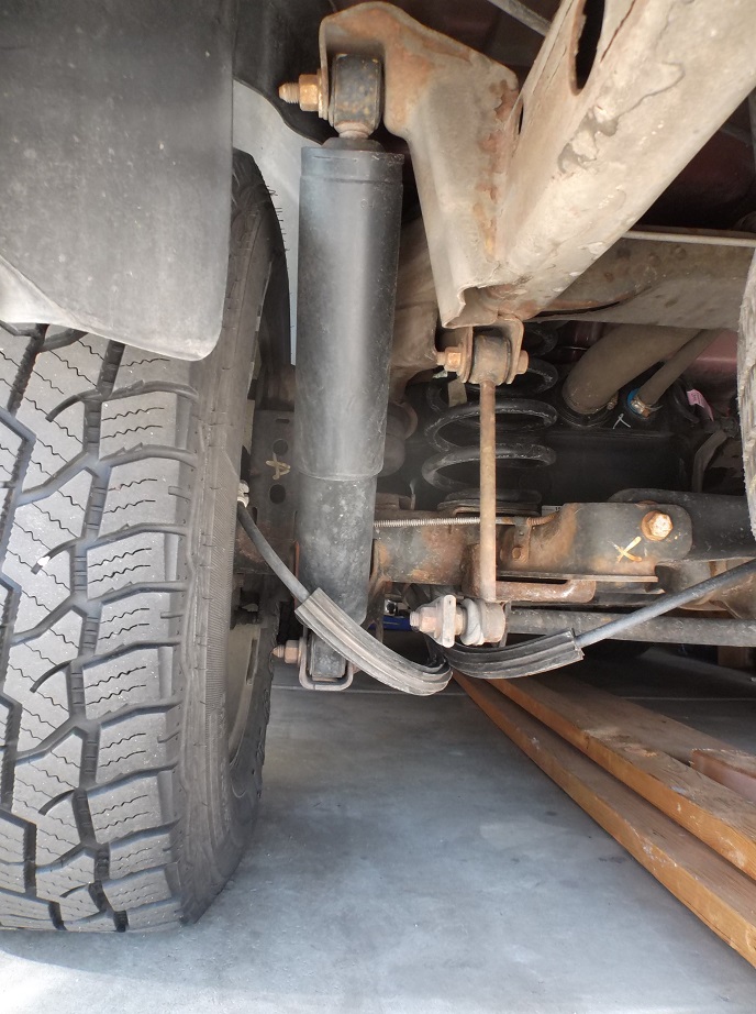

@Tonyrodz that driver's side parking brake cable should be under the sway bar (same as the passenger cable there). Like this:

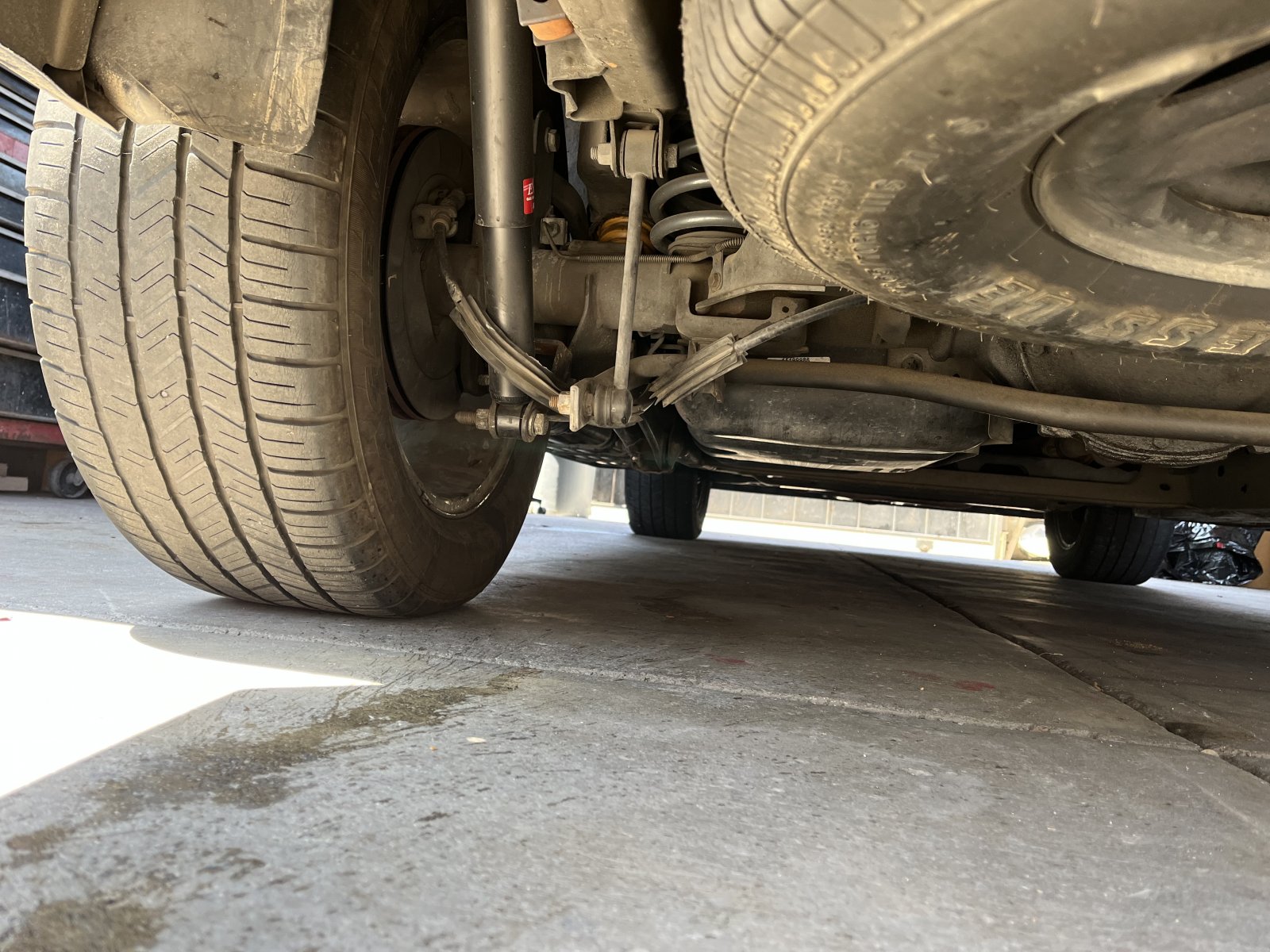

Ok I recently bought this Tahoe , it has a 4 inch drop in the rear , do you think as long as I get the correct shock it would get rid of the moving side to side when I’m at around 65 mph
