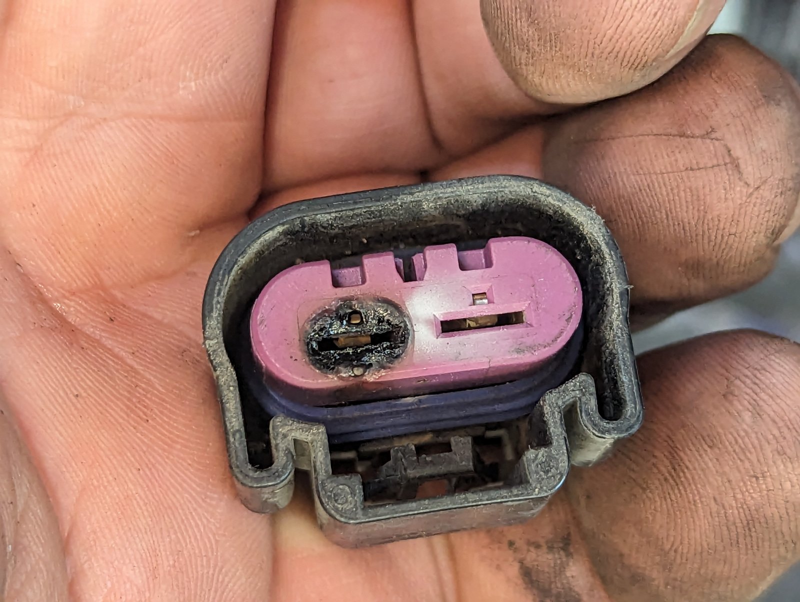

check the electric fan harness & the motor plug side also, at one point there was a recall because the harness would melt. the fix was to replace the harness end with slightly thicker wiring. this is a example of what to look for but sometimes the wires melt behind the harness plug

So much awesomeness. Picture says 1000 words. Cajun style harness connectors.
