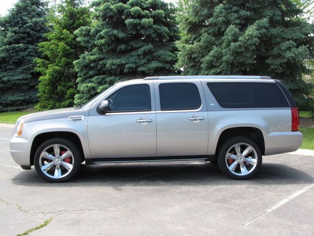

UofMZ71, do you have any pics?
P
protonvx
Aug 23, 2010
242
If the attachment works, that is what it looked like before the lowering kit and with the old wheels. I still have the wheels, the chrome was starting to peel.
