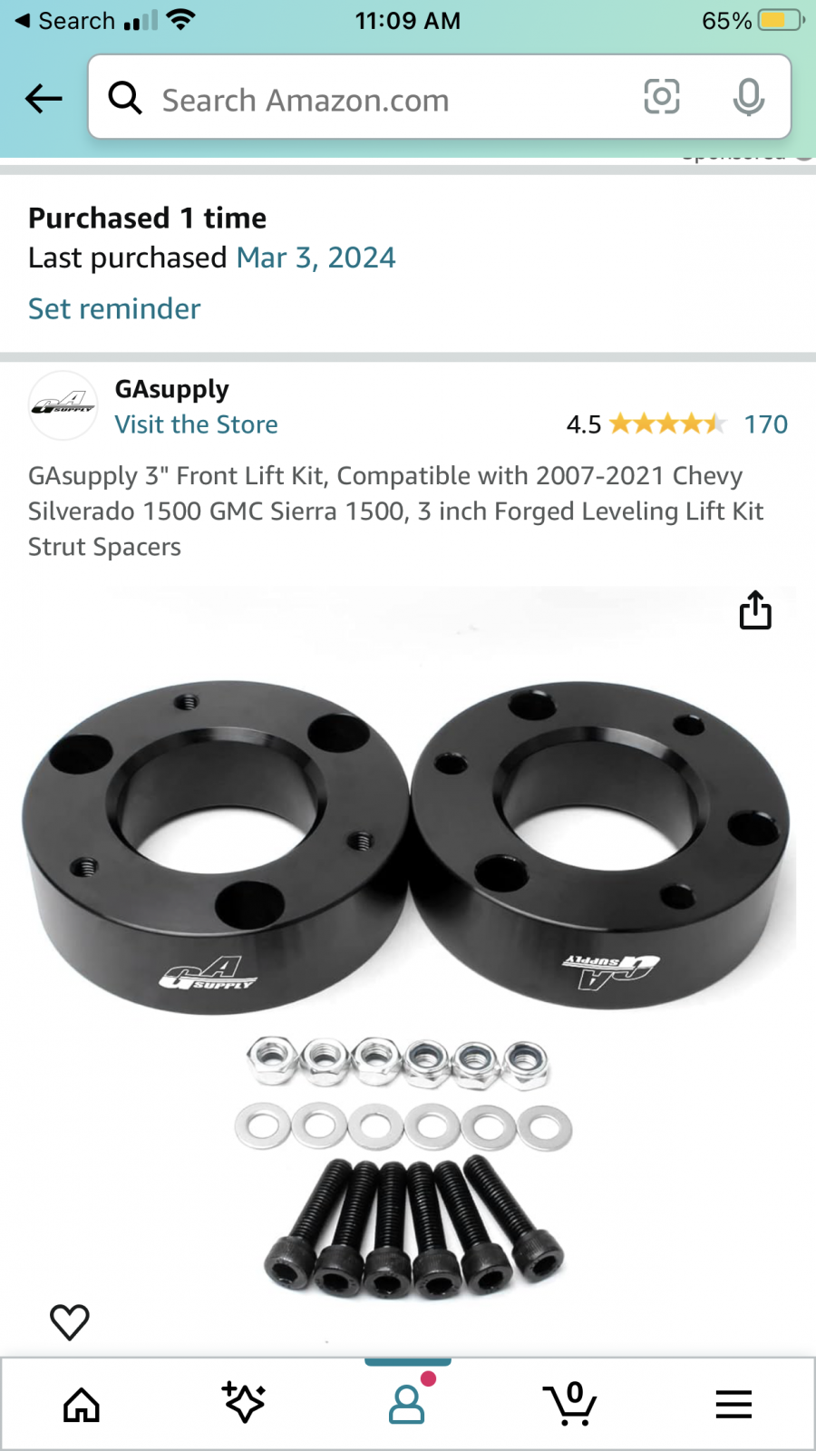

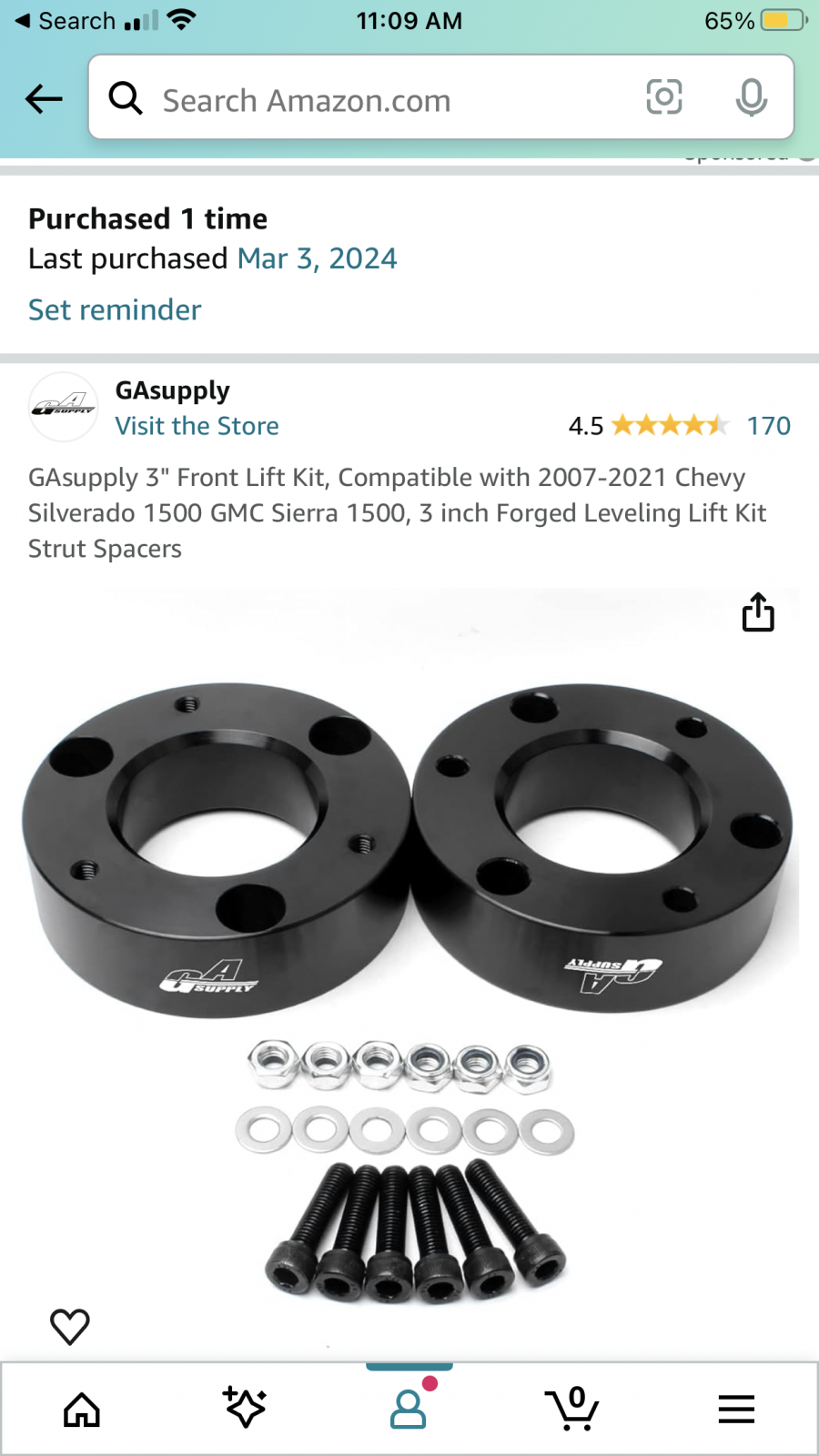

Hello,
To all my magenride folks…
Platinum owners
Does this 3 inch hockey puck level work with the magenride. Moreover, are you still able to plug in that top magenride sensor?
If someone can provide pictures that would be a plus
*THANKS IN ADVANCE

Yes it’ll work plug you can access from the top of the strut tower.
Might need longer rods for the sensors though

So it will plug in but it will need a longer rod? What did you mean by this?

Look on the driver strut on the right side will be a sensor with the rod connected to the control arm for the auto level sensor
For it to work properly you’ll need longer rods to accommodate for the lift

Okay I already had those from my previous 2 inch level. The hockey puck seemed like it wasn’t going to allow me to connect the top sensor so I just went with a 2.5 inch level from the bottom strut

It should unless the wires come out short?
