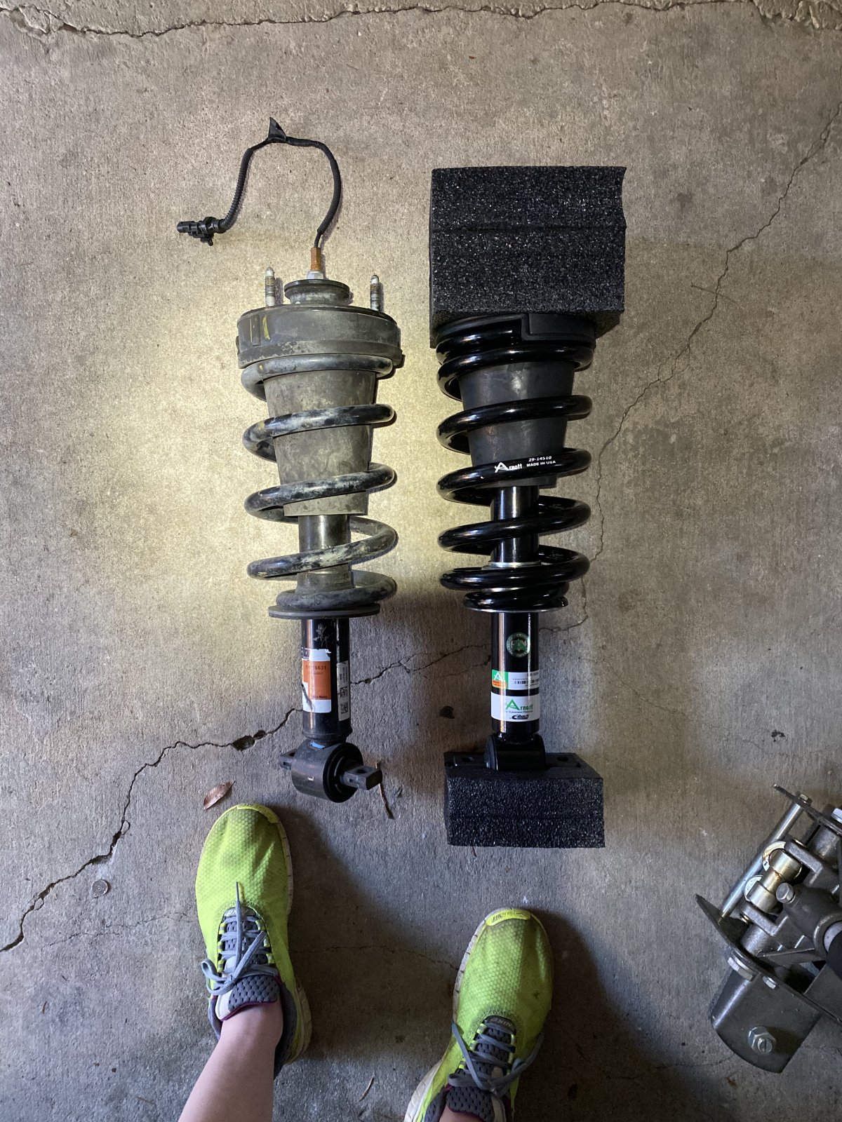

i just noticed in the original port, the ARNOTT uses an EIBACH coil...look at the bottom of the strut body.
hat explains the difference in wraps on the coil.

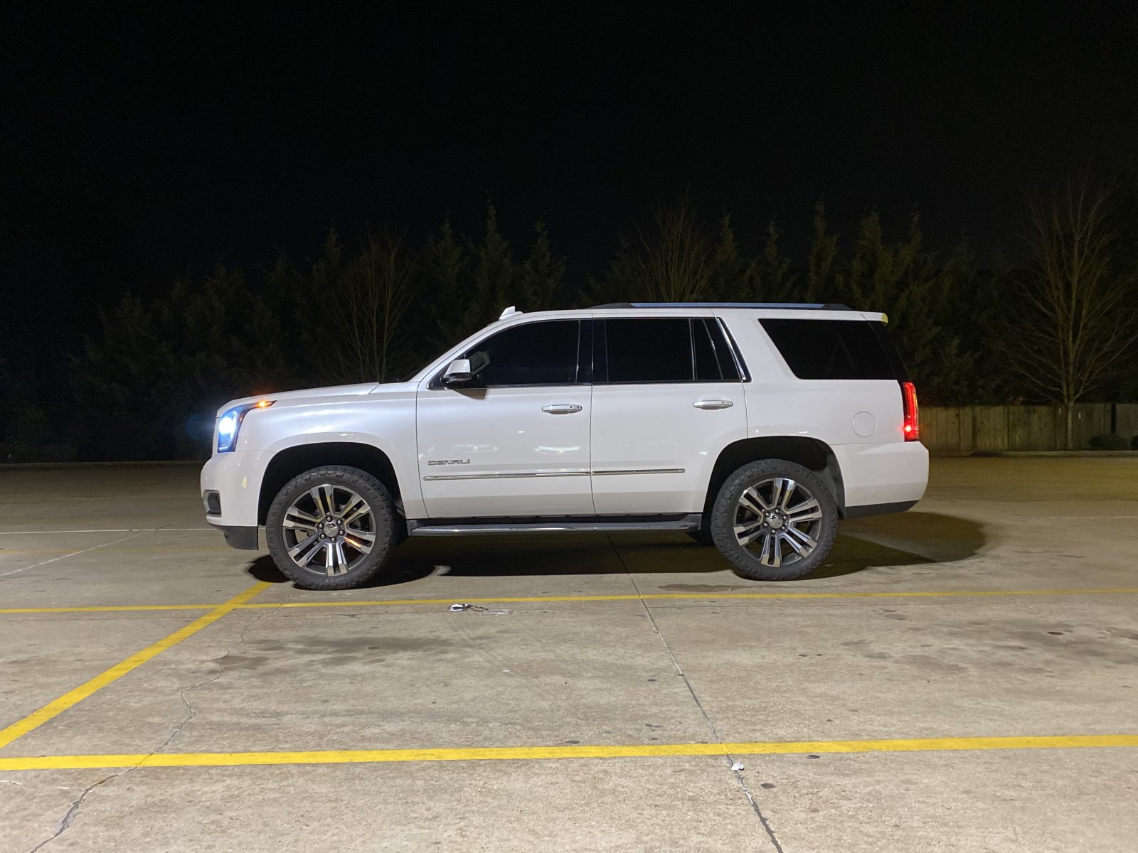

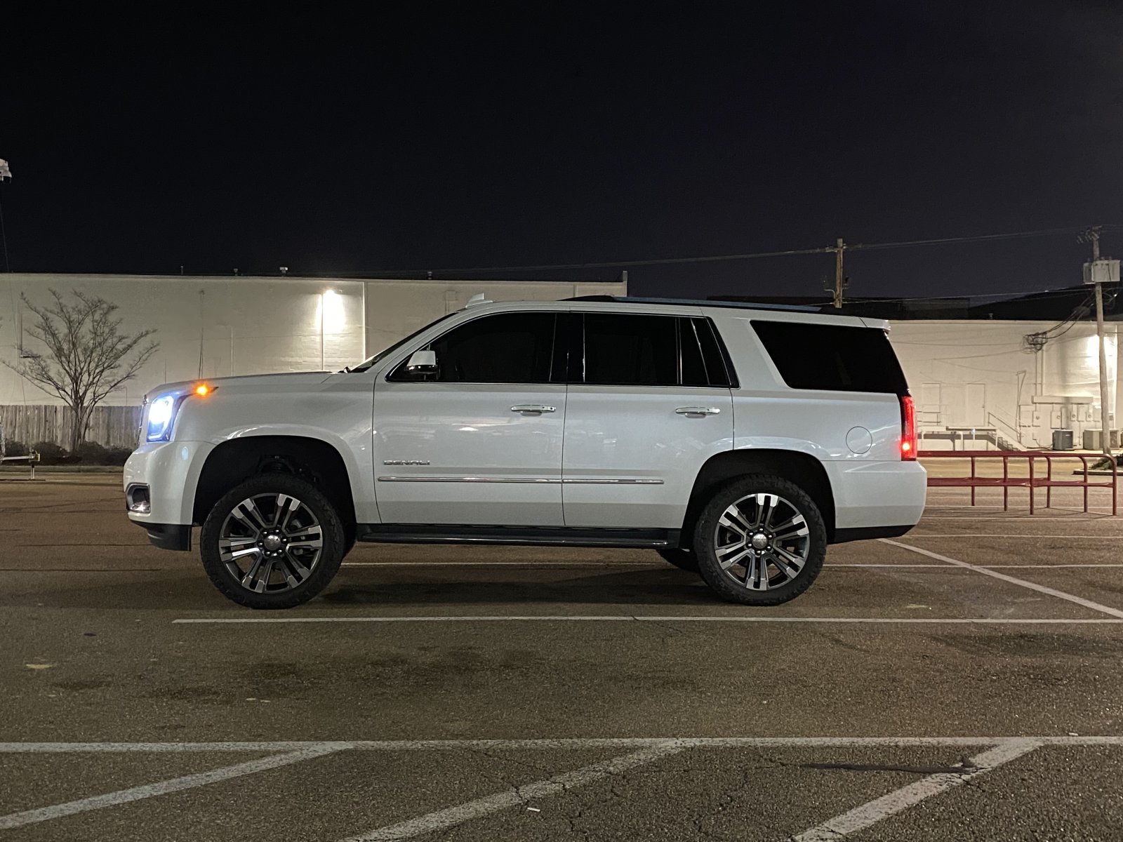

I recently had to replace my front struts (2016 Yukon Denali) at 68k miles due to leaking. Did some research and really wasn’t thrilled about paying close to $600 per shock absorber for the OEM AC Delcos—especially seeing how some were even failing at less than 40k miles. I decided to go with a full coilover replacement from Arnott (model SK-3354) which are an exact replacement—yes they are magnetic shocks. I paid about $450 each after tax from ShockWarehouse.com using a coupon code they had. I originally had a leveling kit, however it is not needed with these coilovers due to their beefier size. See pics below.
2nd pic is with leveling kit, before I realized it would not be needed with these new coilovers. 3rd pic is after removing leveling kit. I considered lifting the rear, but my tires are a bit too small for that much of a lift. I had a good 2 inches more in the front than the rear. Tires are 305/45/22.View attachment 270401View attachment 270402 View attachment 270403

@tjohn0617 What was your level in Pic 2? 2 inches in the front? Considering this but need to know if I will need to take off my front leveling kit.
