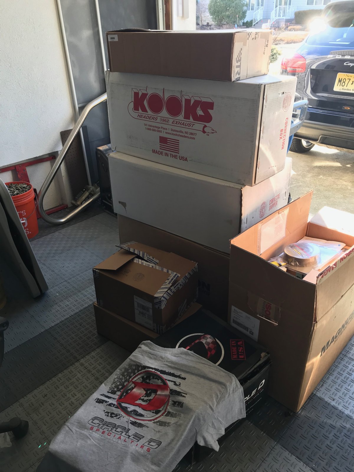

are any injectors provided with the maggy?
that is a good question. still in the box lol, I did see a Bosch package, now you gonna make me go and check.
Edit.
No, they don't provide injectors.
