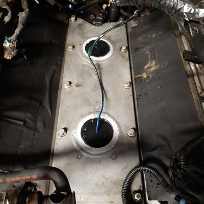

I pulled all the spark plugs wondering if something got dropped in a cylinder (although I was VERY careful about that. I taped all the cylinders shut (see picture) while I was working.

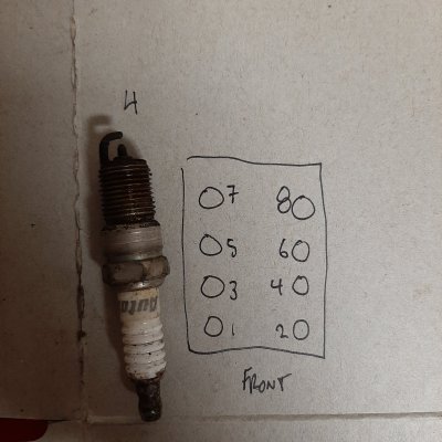

When I pulled two of the driver side spark plugs it sounded like fluid came out of them. I wonder if I have a stuck open fuel injector that flooded the cylinder with excess fuel while I was priming the system?

Note picture says coolent, but it was gas. Two of the spark plugs were wet. I checked the oil and doesn't seem to be any other fluids in it, at least on the dip stick.

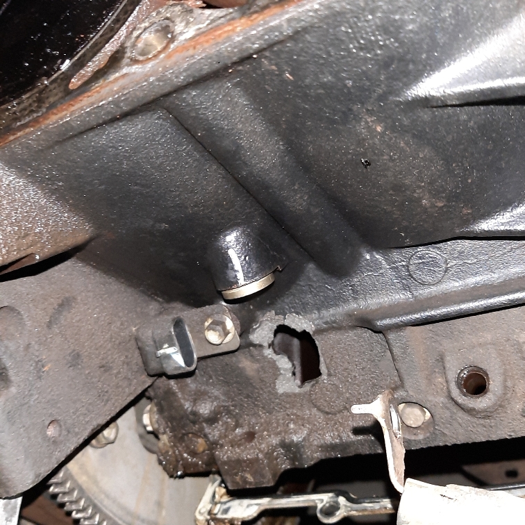

It's official connecting rod on cylinder 8 is busted. I'm pretty sure it was the injector. Got stuck open and in the couple minutes I let the pump prime it flooded the cylinder. Here's a borescope video of me spinning the crank. You can see the valve move but the piston says in the same place.

Holy shit. DAMN
You think this was around before or after the injector service?
