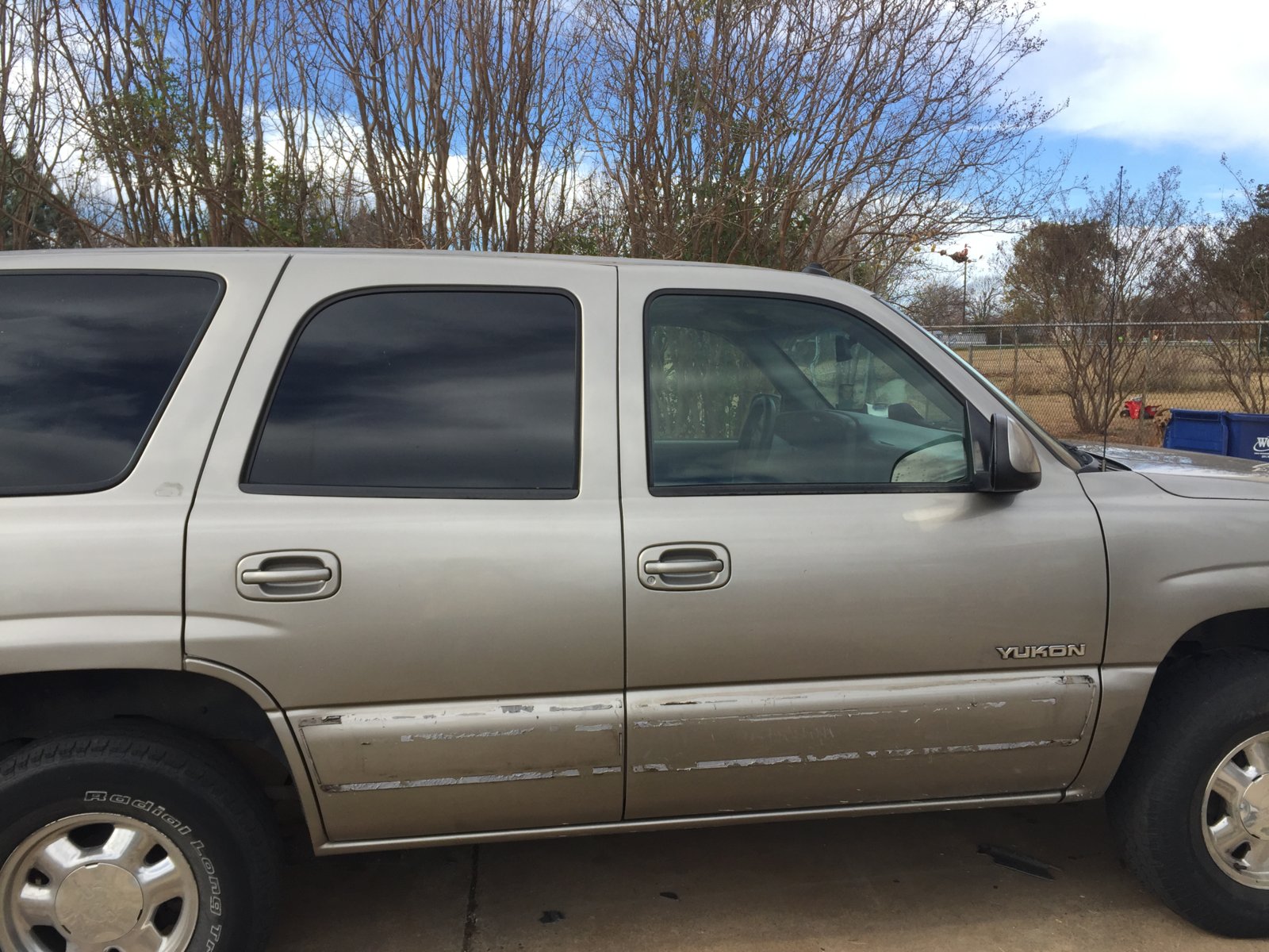

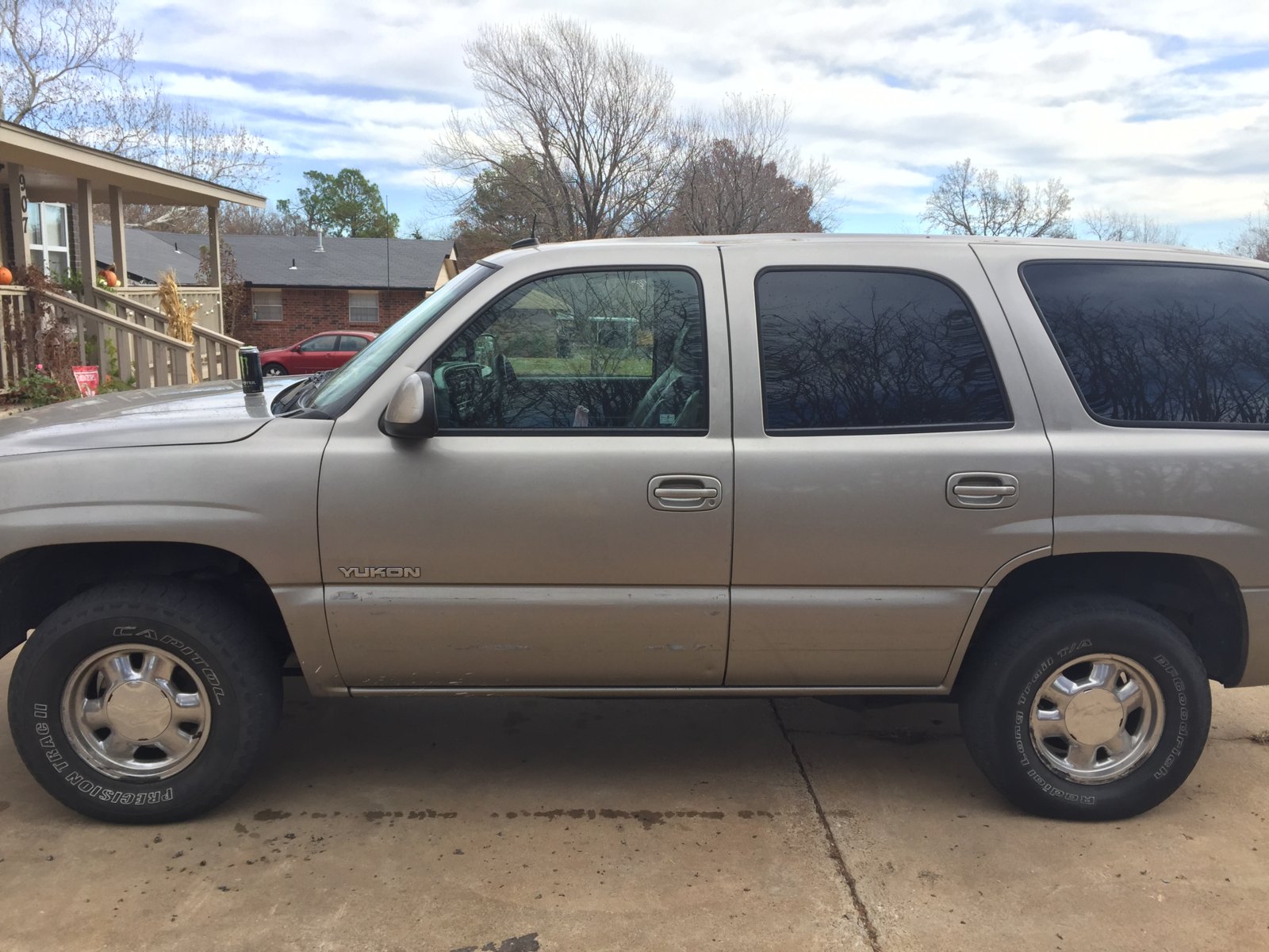

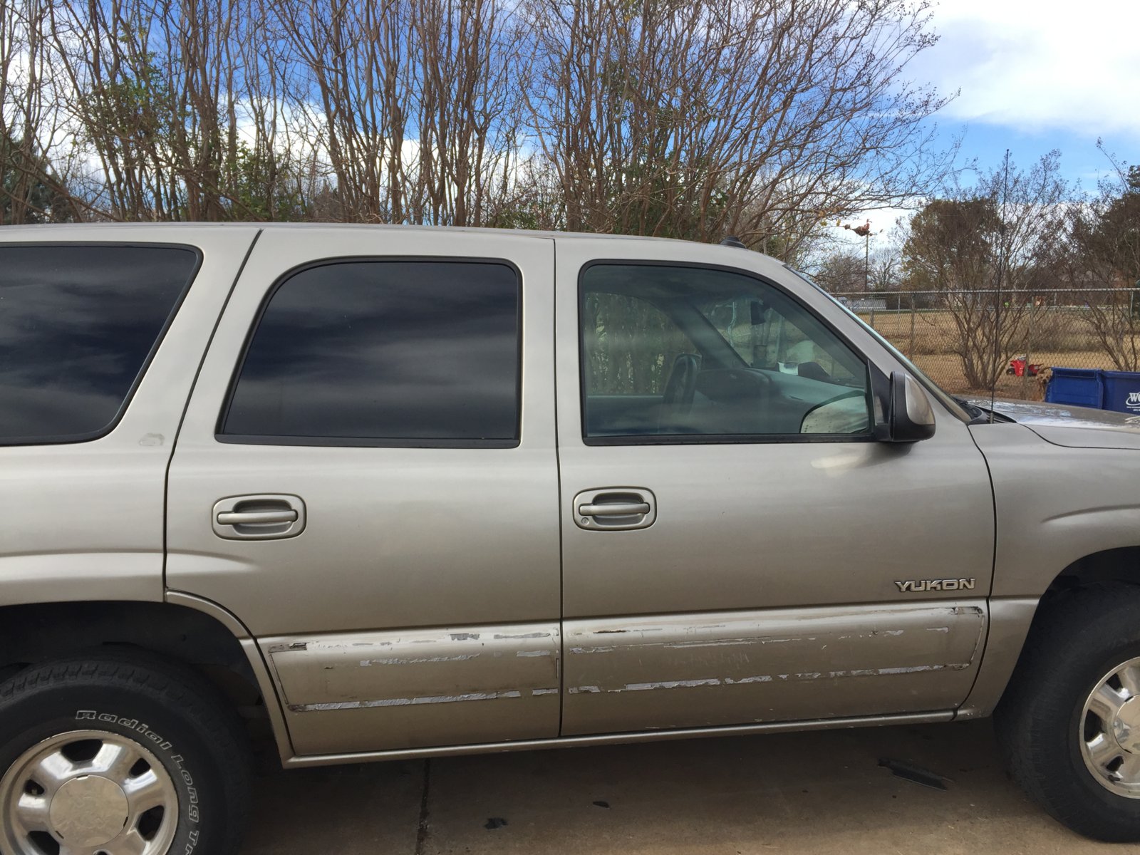

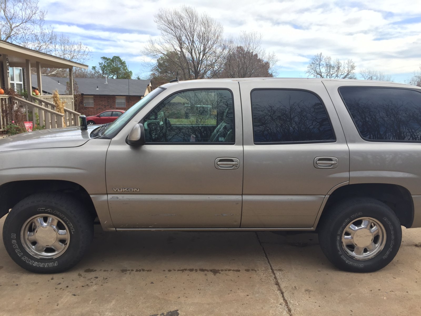

This morning I got up and continued to work on removing the side moldings. I’ve been using Goof Off and a Metal Putty Knife. I’ve scraped my paint a few times but mainly spots I can just buff out. The hardest part so far is removing the actual panel, and the most time consuming is waiting for the Goof Off to weaken the glue.
Drivers side is almost done:
Passenger side is just getting started: 0DA1A7CF-BCB6-452D-9CA3-F1CDA6D3096E.jpeg
I have work in about 30 minutes so I’ll have to finish it up tomorrow morning, then it’s on to repainting the roof rack!

OMG a putty knife?!
3M sells a rubber buffing wheel that removes that crap and stickers for like $20... Caveman!

Welcome and fyi Those led guage lights will not work in your 03.
03-06 have to be soldered in.
Being cold out doesn't help your cause with the trim glue.
I know you're on a budget but please invest in the eraser wheel. Not only is it safer for your paint, and fingers lol, but it's waaaayyy faster. Plus you can use it over and over again on your next vehicles and friends vehicles. They last awhile. In the end you will spend more money on bottles of goof-off.
But most importantly you're on the right track getting those ugly side moldings off to begin with.
