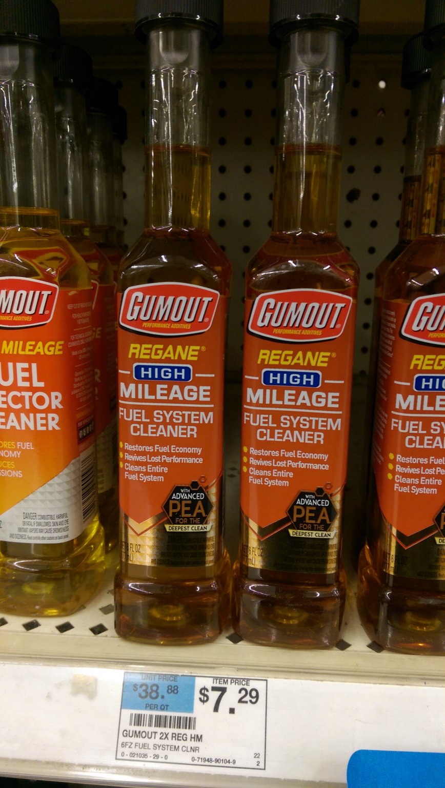

I updated my findings of using Gumout Regane HM. Ran 10oz into a 1/4 filled tank, then two days later filled tank and dropped another 5oz in tank. So far I went from a high of 11.5MPG to 13.8MPG on two tanks since then. My Yuk is also more responsive and not jerky from start which I initially believed to be trans related.
As I said, my next endeavor will be running Kreen through an entire OCI
