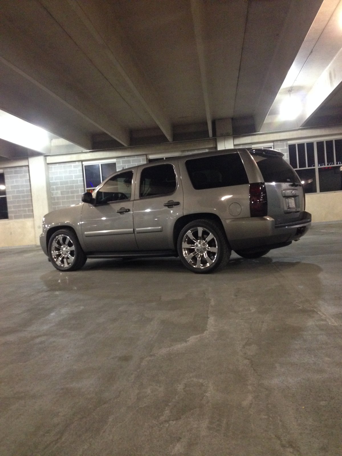

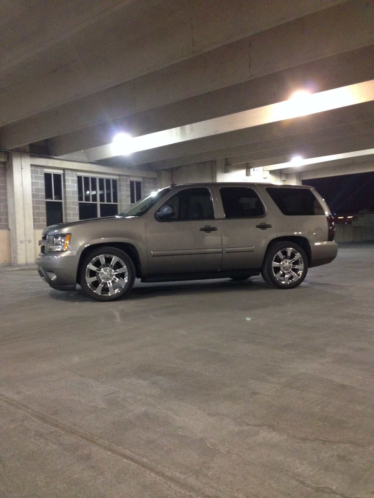

Here’s my 2008 with a ground force 2/3 drop (2” drop coils in the front and 3” coils in the rear) and djm shock extenders. I also had the adjustable panhard bar but that’s because I had it laying around, it didn’t really need it. 285/45/22 was the tire size. Rode like factory.

Looks great! Looks like you keep it show car clean as well. 285/45/22 is the tire size I would do when I get my 22 inch replicas.
