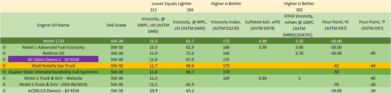

Gee thanks Nate, more research to do! ;)
This oil was originally eliminated from consideration because it was not GM Dexos 1 approved. As of late last year it now is for GM Dexos 1 Gen2.
The website specs are different than the specifications included in the August 2019 MSDS. Walmart's photo is of the old, non Dexos oil bottle.
That being said, its viscosity numbers are still lower than the ACDelco and Shell Rotella Gas Truck and note that I'm only examining 5W30.
Looks to be marginally better than plain old Mobil 1 which allowed my motor to rattle a little on start up.
