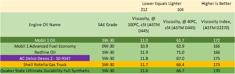

Clay, this is a chart I made for comparisons:

I looked this up today and the viscosity specs are little different from regular Mobil 1 5W30. However, it is a Group IV based oil, like M1 used to be before 2010. Still "thinner" then the stuff I just bought and more than 3X as expensive.
