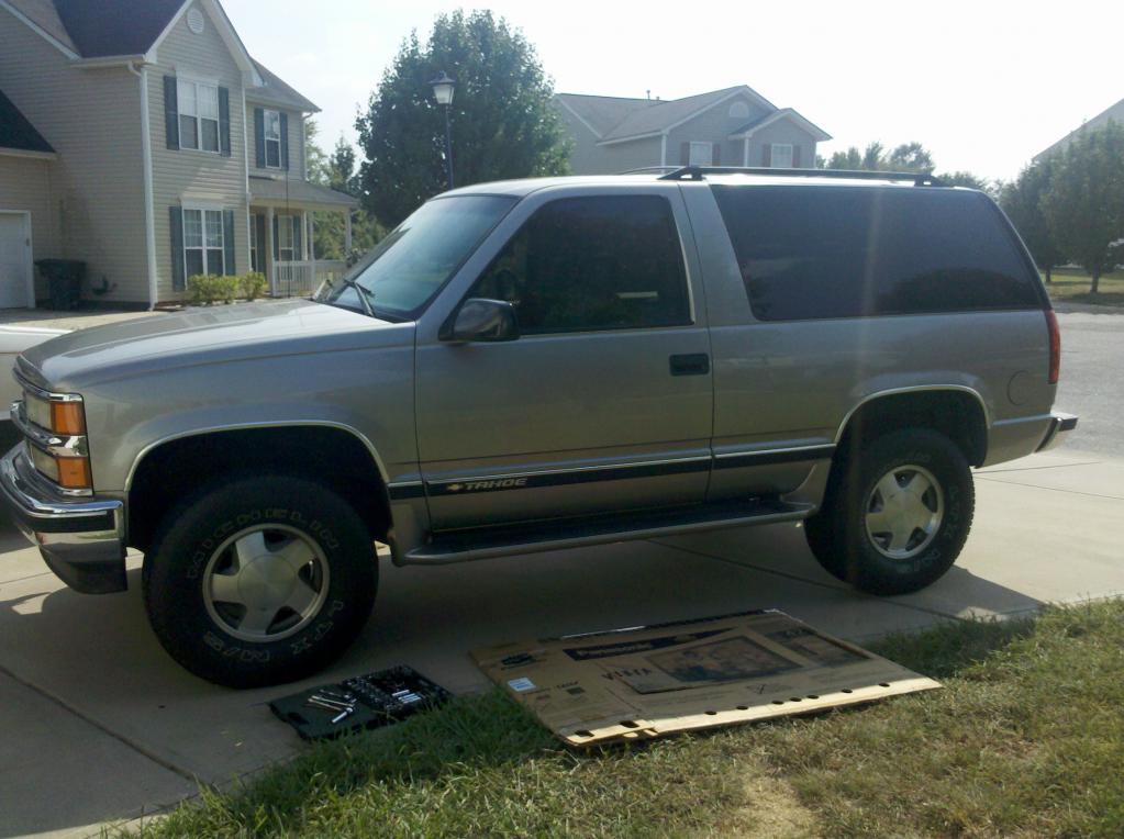

molding removal
ahumps32
Jul 20, 2010
16
goo-gone and fishing line. with a lot of elbow grease
JB11
Aug 13, 2010
43
heat gun or hair dryer to get it off, then 3M GENERAL PURPOSE ADHESIVE REMOVER for the glue, followed up by meguires cleaner wax
HotCarl
Mar 29, 2010
197
13
ID/WA
I used a hair dryer, TSP/water mix, then a 3M stripe off wheel, then cleaner wax, and it looks awesome now.
96ProCompTahoe
Apr 30, 2009
2,606
11
IN
didn't use anything on mine. let it sit out in the sun on a 100 degree day, pulled the moulding right off, then just used my thumb and pressure to roll off the glue. good wash/wax looked like it never had mouldings.
drowndindreams
Aug 3, 2009
1,074
Unknown
I second that, it was a lot of work though and ended up with a few blisters.
T
texasmade
Aug 15, 2010
17
southtexas

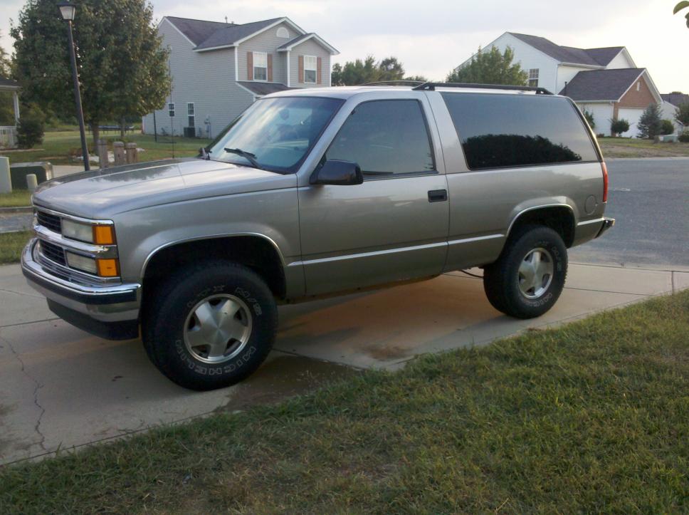

thanks for the ideas ppl ya ive been looking at the yukons/tahoes with out the moldings and it looks alot better..
raptorforme93
Aug 29, 2010
775
18
Tampa, Fl
Are you talking about the molding around the wheel wells? Ive been wanting to take it off but I dont know what it looks like or how its attached. Is it just glued on there? Do you have any pictures of a tahoe with the molding taken off? Thank you!
