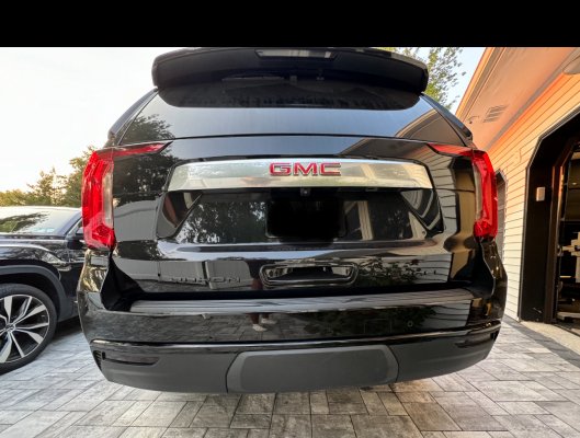

I have pics for anyone trying to do it, I might do a write up. For lower pieces there are two crews on each side and they pop right off. Not a difficult project once you get over the drilling part of these rivets

just did the rear bumper trim as well, oem part number 84371058
