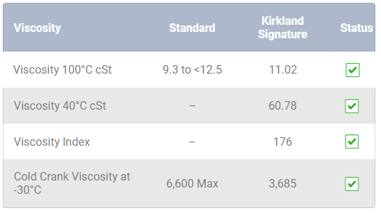

Do you happen to know where Kirkland (Costco brand) is at on that list? My last oil change was done with that. It was like $38 for two 5qt jugs

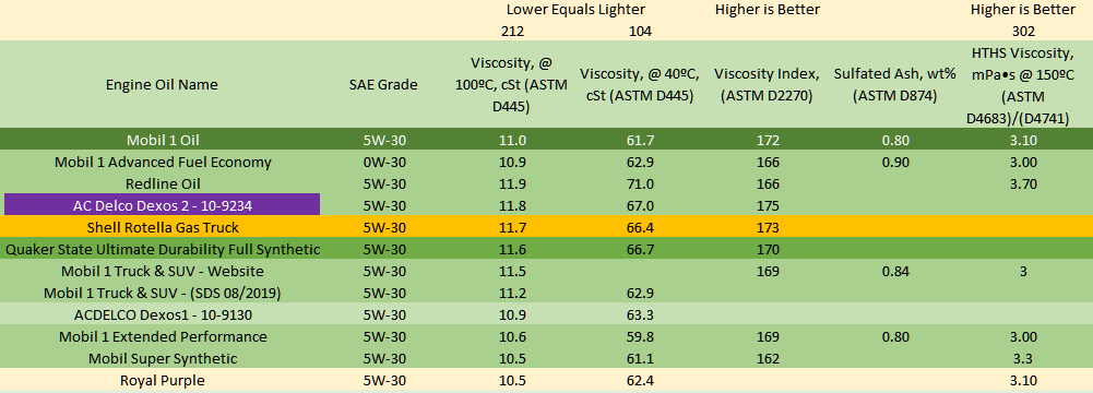

The above was taken from: https://pqia.org/kirkland-signature-full-synthetic-sae-5w-30-motor-oil/
I know the numbers don't seem far off and I am far from a trained expert but my motor does not rattle like it used to with the ACDelco oil versus the plain Mobil One. We were going to try Quaker State next. Too bad Shell discontinued Gas Truck.
More importantly, how does your engine perform on it Tom? Oil consumption and cold start noise?

View attachment 396414View attachment 396415
Hard to tell recently. Cold start noise is a bit louder due to the broken exhaust manifold bolt on the rear drivers side. I have new ARP bolts to install, but need to get new gasket before taking the manifold off to remove the broken bolt. Probably won't get around to it until after school/work gets out at the end of May.
