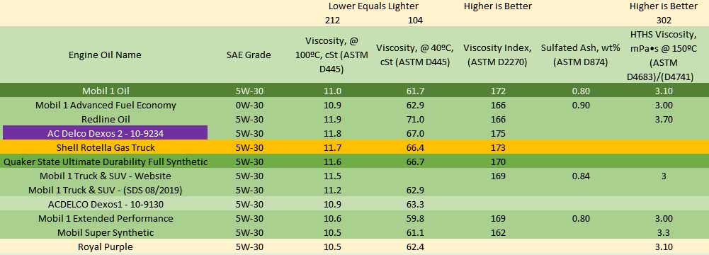

View attachment 396414View attachment 396415
The above was taken from: https://pqia.org/kirkland-signature-full-synthetic-sae-5w-30-motor-oil/
I know the numbers don't seem far off and I am far from a trained expert but my motor does not rattle like it used to with the ACDelco oil versus the plain Mobil One. We were going to try Quaker State next. Too bad Shell discontinued Gas Truck.
More importantly, how does your engine perform on it Tom? Oil consumption and cold start noise?
Where was the top chart from? Looking for more names on the reference.

...The Mobil oil has lower viscosity numbers and my 3 motors don't like it.
Can also confirm, Mobil 1 5W30 makes the engine run noticeably noisier overall (incl. about 1sec. cold start chatter) compared to a different brand 5W30. What works well for me is using the ACDelco PF48E filter and any full synthetic 5W30 with dexos1 or dexos2 specification.
