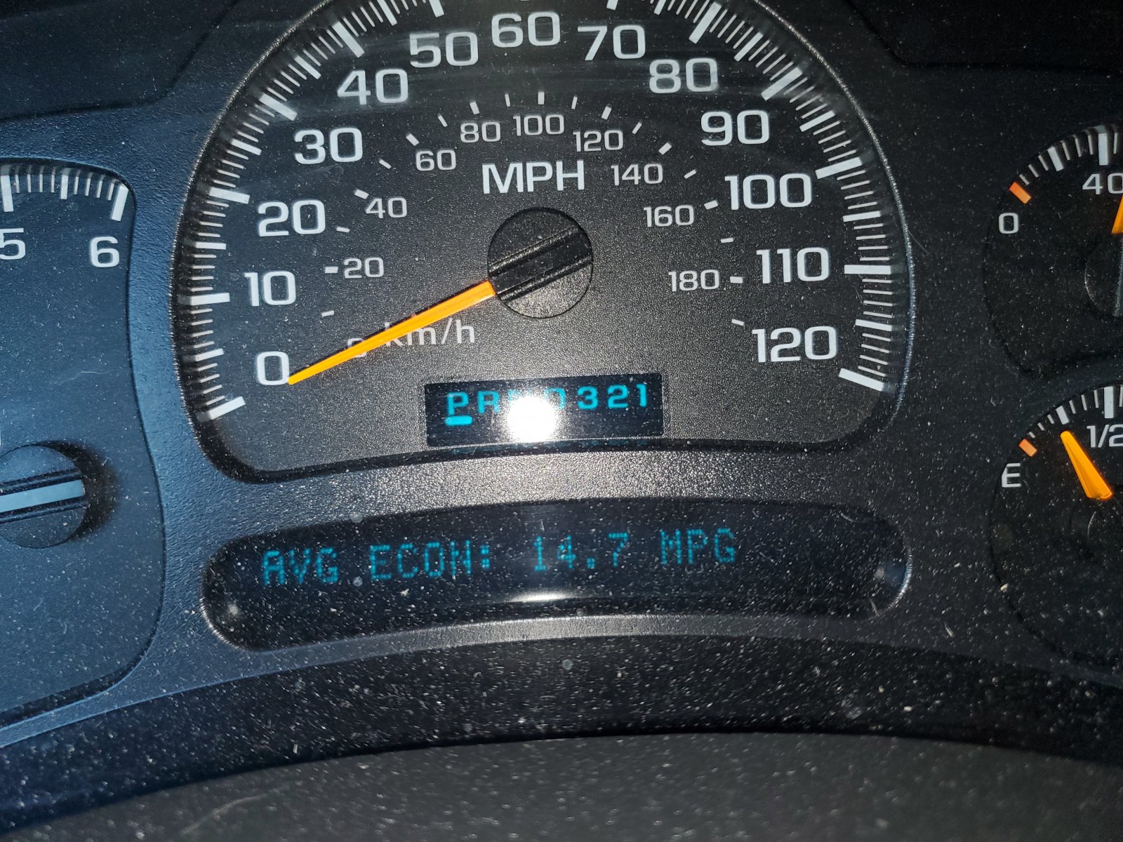

Hi everyone, I was wondering if 12.9 mpg combined is normal on my Yukon with 150k miles. What can I can check, clean or replace on my Yukon for better gas mileage besides better diving habits. Any help is appreciated. Thanks
