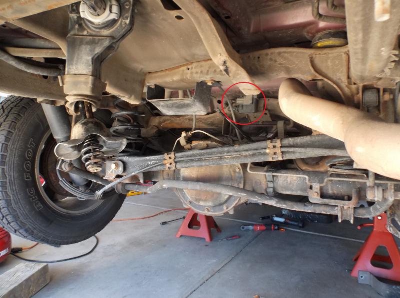

Where is it located on my '05 ??

Mine is Flex Fuel so if your isn't, the evap system may be somewhat different. Here's a pic of mine, looking from the rear with the fuel tank removed. Vent valve is in the red circle.

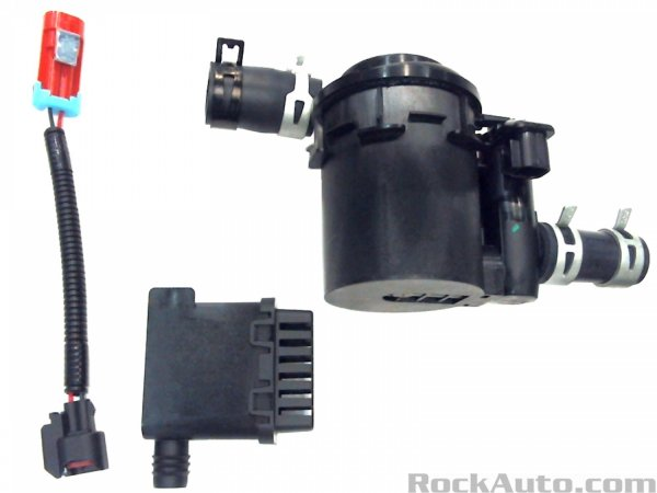

Yours is probably the newer, round one with the external filter:
