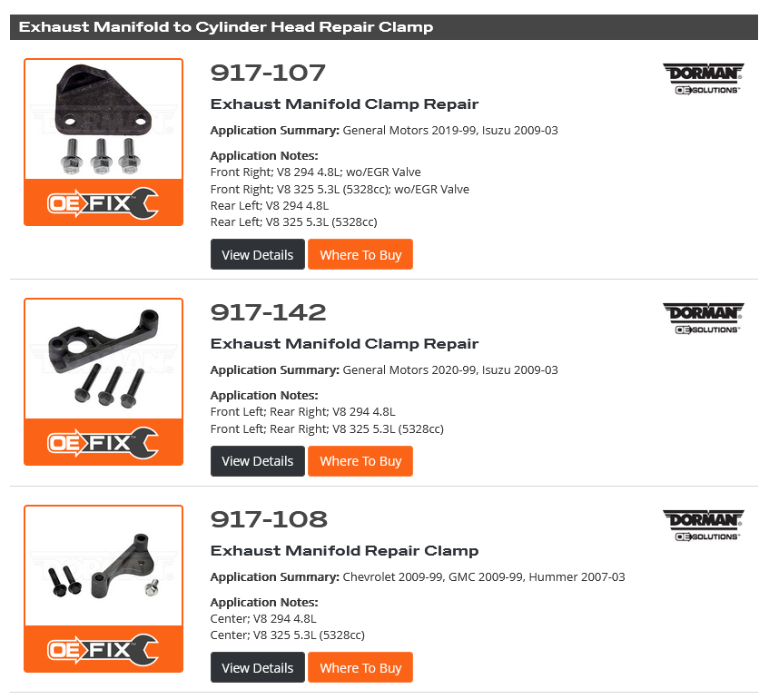

Put new plugs in today. It was wayyyy over sure. Average gap on them was .080"! Pass rear plug was a little difficult to get at, but removing the wheel well liner made it pretty easy.
Found it has a broken exh manifold stud (front one) on driver's side.... Bummer!
Next up is driver side abs wheel sensor. Then im going to fix or replace the front seat, neither one works lol.

front driver side, at least on my truck would be the easiest to get to. mine broke the rear drivers side. little worse but the clamp thing seems to be sealing it well. worth 20$ not to have to pull the manifold for a while.
the tend to suck air and mess with the o2 readings, might be worth moving that up the list.

clamp thing?
