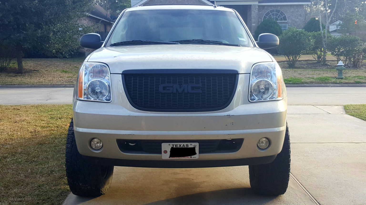

It was cleaned and detailed. Stayed that way over night at least. Couldn't help myself and had to grab a pic. Had it for a little while now and I still like it.

Good looking ride. Just got mine a week ago. Used to take my Jeep out to play in the mud. Haven't quite made the leap yet with the Tahoe. Any issues with clearance or concern of not having armor protection in place of the plastic rails?

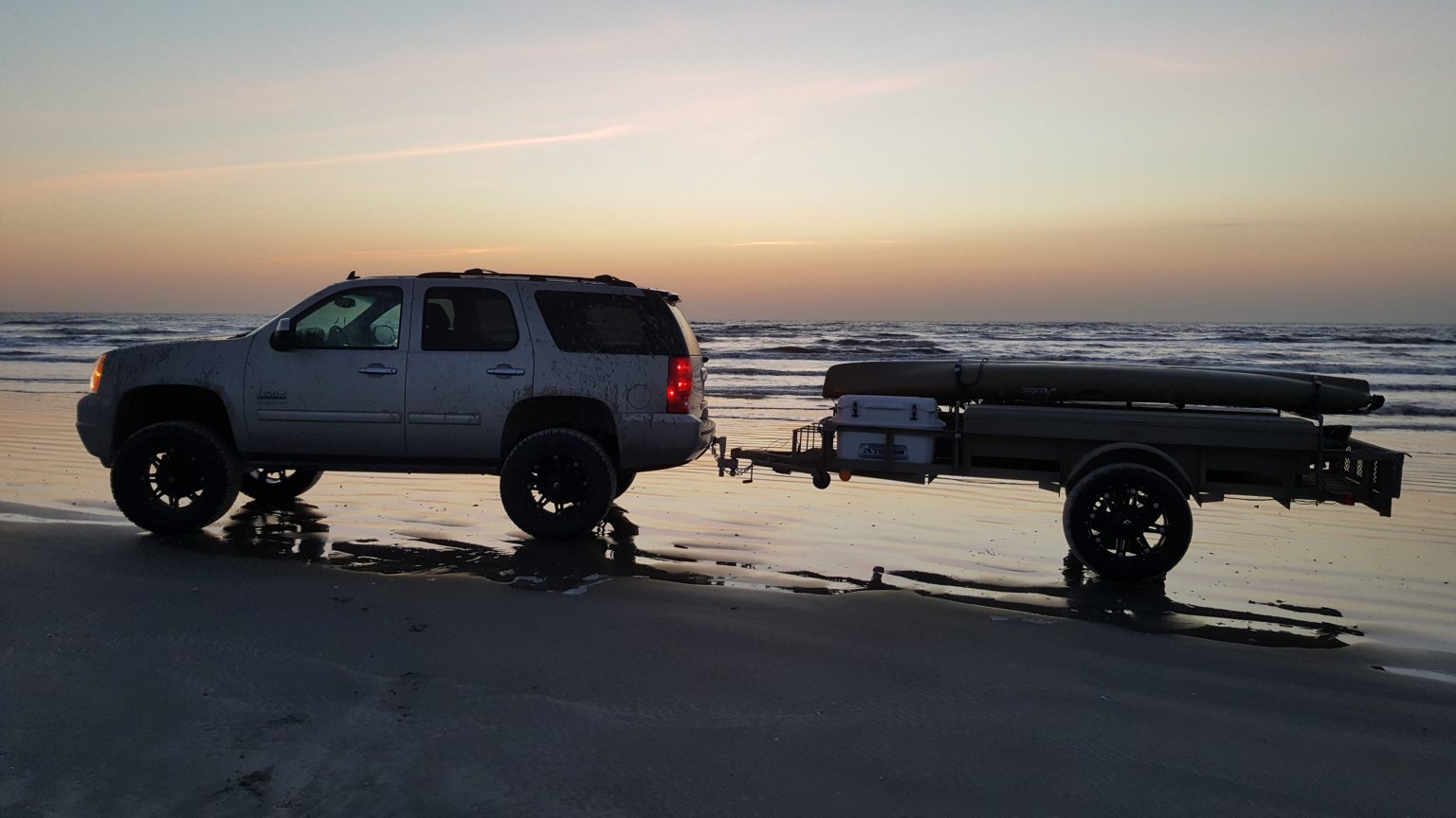

Been a while since I checked out the forum. Still digging the ride. Will mention that putting wheel spacers on the rear made the ride considerably more stable. Well worth it. Currently modding the trailer (a lot lol) to match the Yukon... It's coming along!
