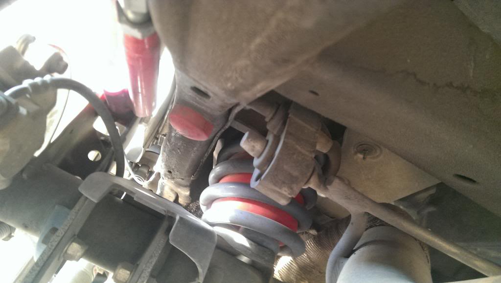

For the rear, the back is as low as I can go without cutting stuff up. The upper spring perch is part of the rear bump stop bracket and is what the bag attaches to so I can't do the free travel mod. I've looked in to this a lot and found my definitive answer (before cutting mine) from this thread here in post 5
So you haven't done the free travel mod? I cut my brackets off this past summer and haven't had any problems (not saying there won't be though) but for the most part the spring perch is still welded onto the frame so cutting off the bracket doesn't mean the perch comes off with it. I have thought about welding the remaining bumpstop bracket to the frame but so far there hash't been any "bending out/in" of the actually perch.
The metal on the right side of the bump stop is what I am referring to, i basically cut and grinder away all of the bump stop bracket visible on the outside and left the inside "hidden" part alone. Lowered 4" inch in the back that is how much space I have till frame. The red bump stop is an inch tall for reference. I used use an angle grinder and removed the gas tank for safe measure.

Thanks for that pic. In the thread I mentioned, it looked like you had to cut it all off... I might be doing some cutting this week...
