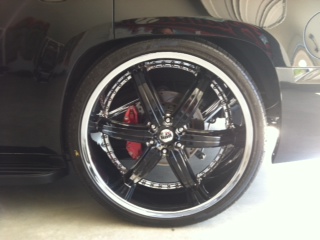

Nathan, Didn't know you went all in. Looks great. I just wanted to reiterate what's already stated, you can do the travel mod without affecting the perch. Chopped both my burban and the esky.
Doesn't look like your front is sitting as low as either of mine sat when emptied out. Looks like maybe 3/4 to 7/8" higher when dumped?

Yeah I think I'm gonna cut them next weekend. Just trying to find the time. Do you have any good pics of yours cut?
No. I noticed that too. No idea why. I've been contemplating doing Tony's strut mod, but also might just go ahead and tub my fenders and then do the new Belltech spindles or 3" A-arms.
Not sure what to do about the rear. I'm close to doing a mini notch and just go as low as possible without going in to the body...
