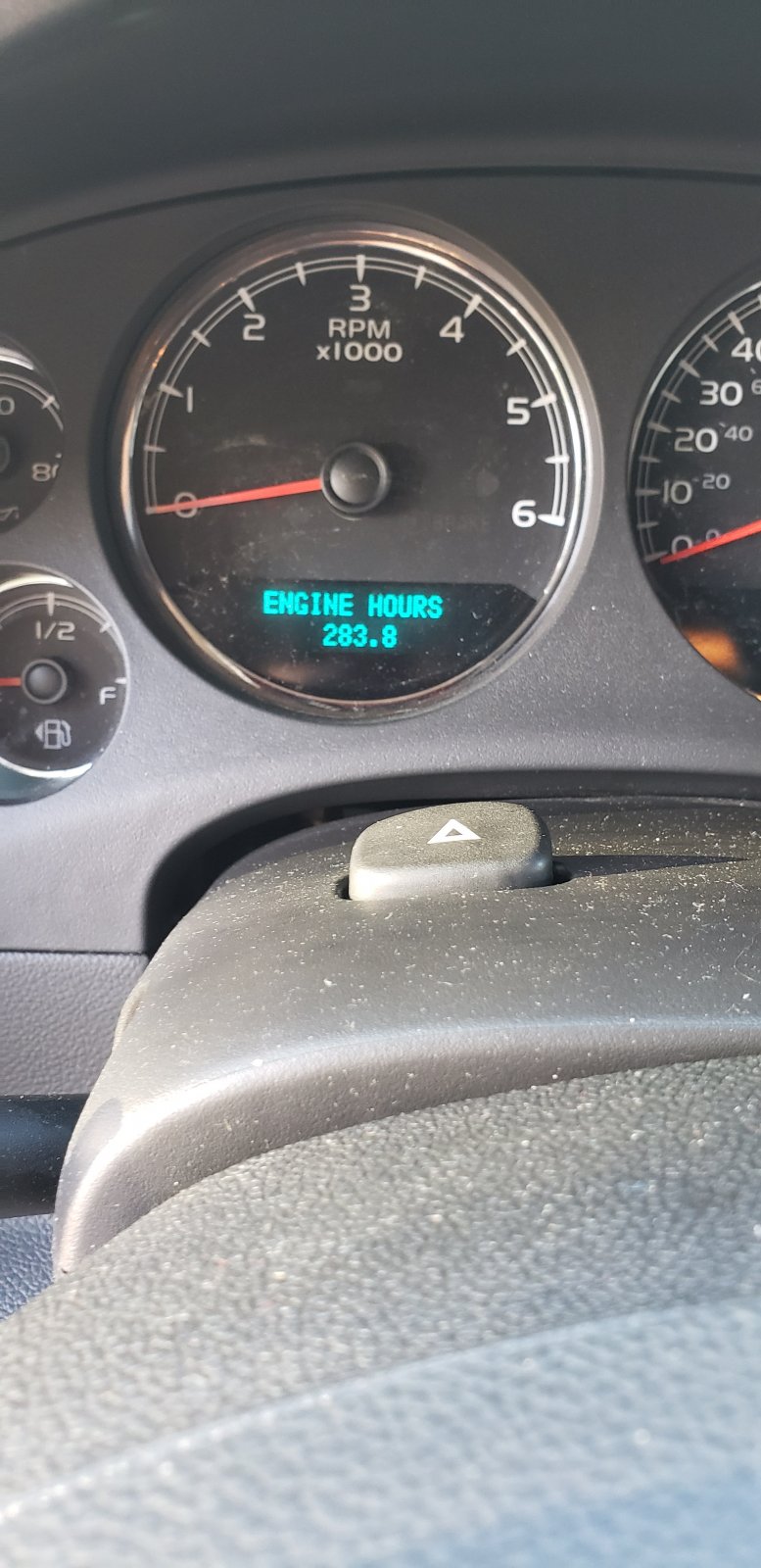

Here is some more pics of the driver side interior and the new head unit with the runs hours.
Don't mind the wires I'm currently working on the backup camera and hdmi to the back seat.

Pretty sure it's an SSV and, with those hours and the mileage, it's like its only purpose was to make a few highway runs ever so often. Lots of PPVs/SSVs can have low miles, but they tend to have high engine hours from extensive idling. Yours has low miles AND hours. No DIC switches, no center console, no body molding and those wheels all point to it being an SSV. Cool score.
