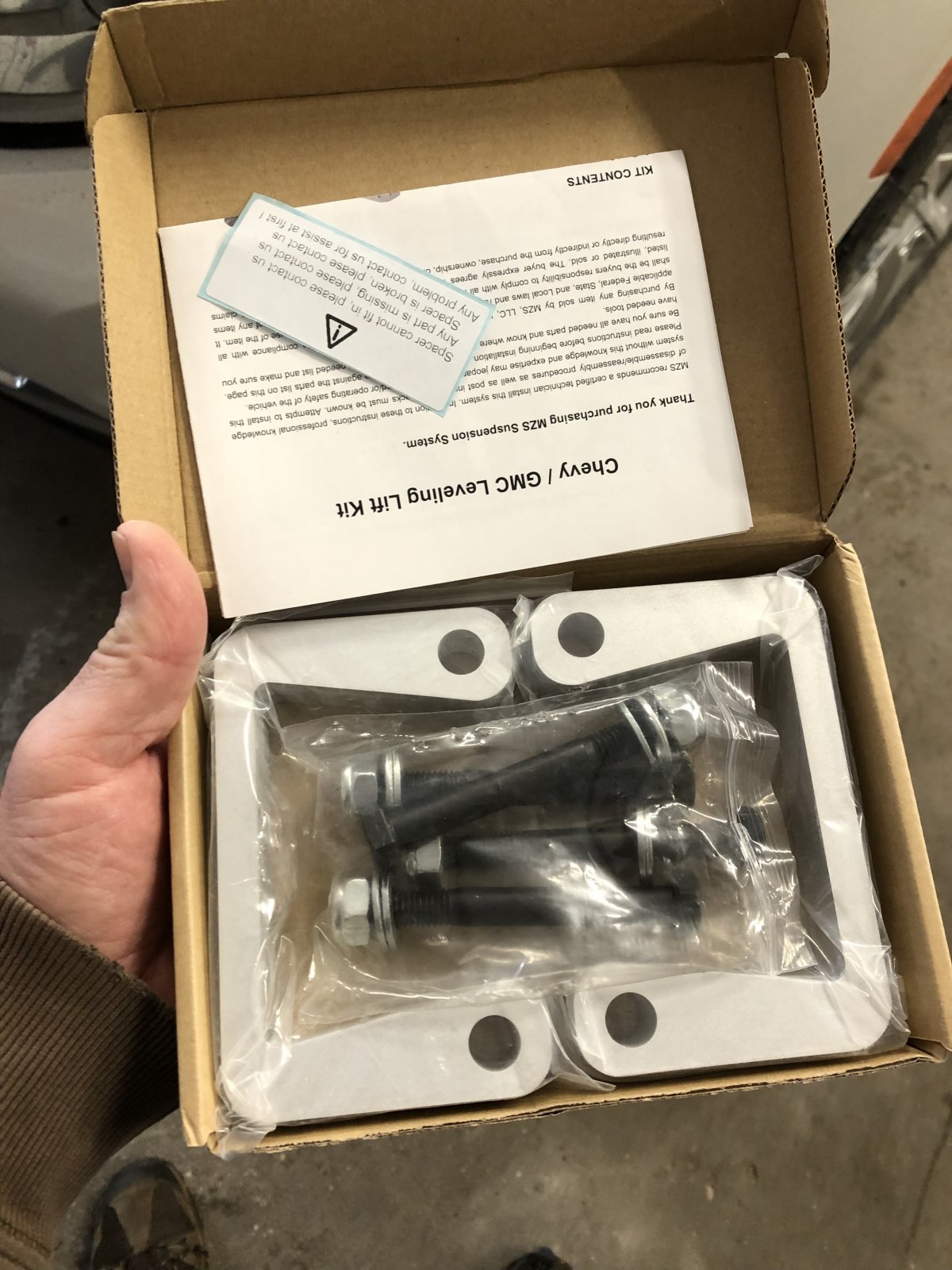

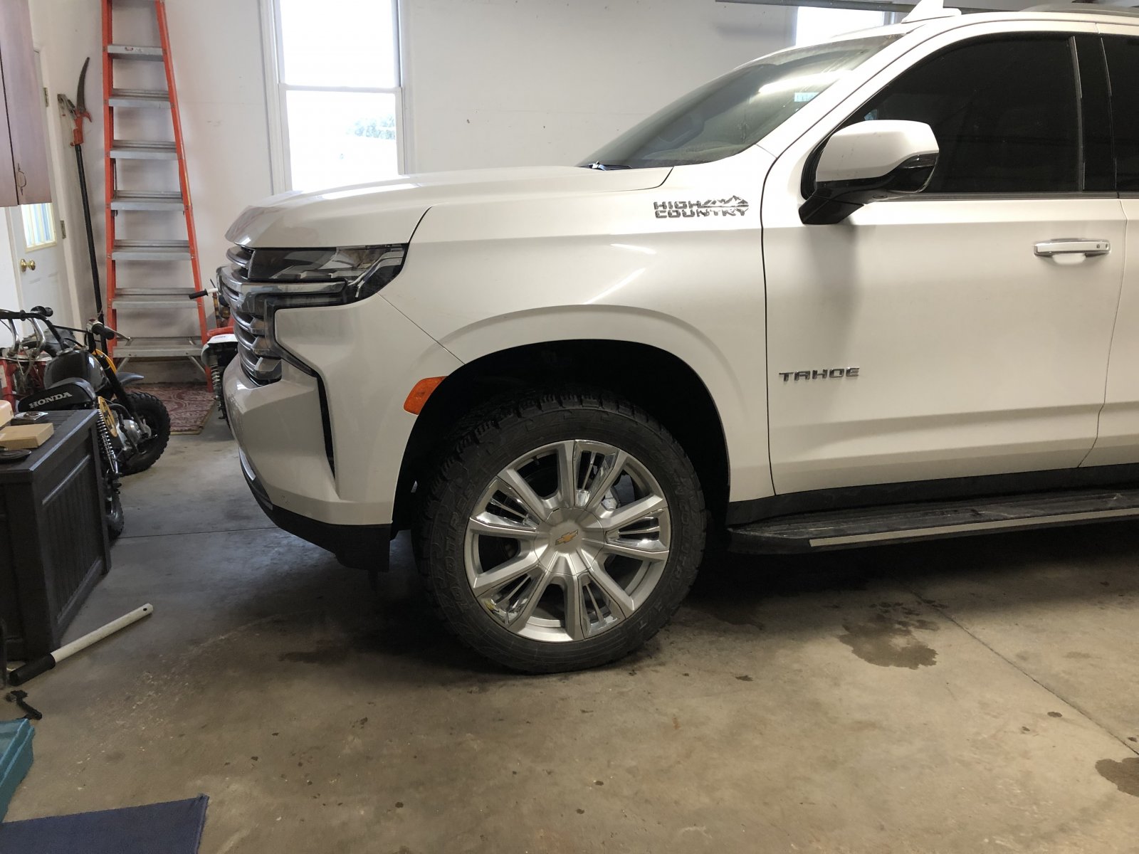

Just installed a 1.5” leveling spacer (lower strut style) from MZS. This is on a high country with no air suspension. Honestly not sure if these have mrc suspension or not, but i have been told they do. I could not find any sensor arms like on the last denali she had which needed a small spacer to keep everything happy and not throwing codes. There is no spacer with this kit, and no codes have been thrown, soo…..

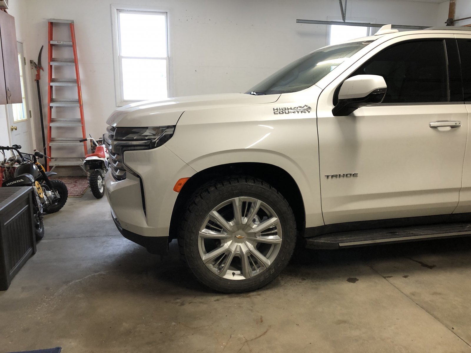

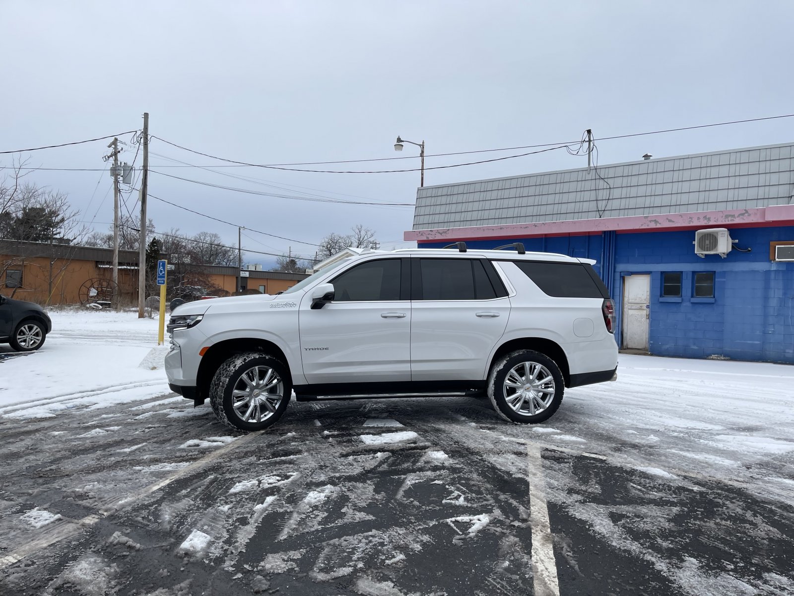

All turned out well and it leveled it off nicely without looking like its sagging ass.
The kit comes nicely packaged with directions that have color photos.

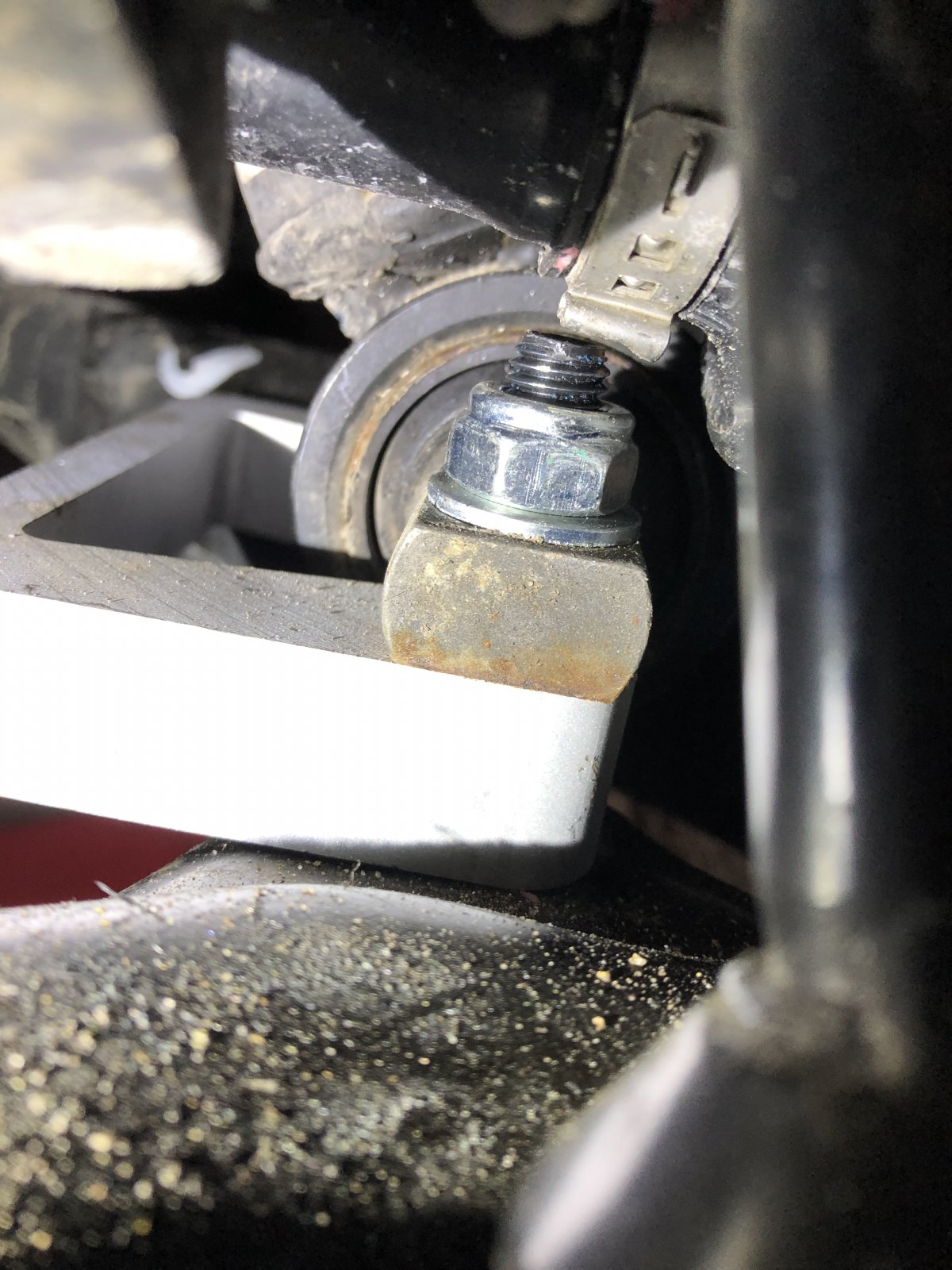

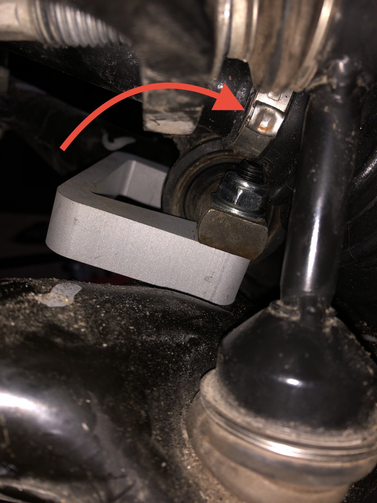

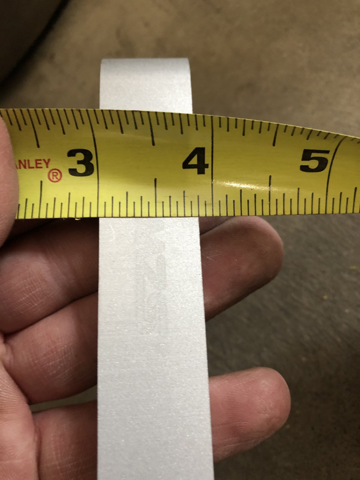

The spacer is 7/8” thick. I dont think a thicker spacer could be installed, because at full droop the bolt head and nut actually contact the rubber on the axleshaft seal as well as the crimped portion of the metal clamp. When at ride height, there is plenty of clearance.

Oh, and the tires are 305/45/22 toyo at3’s, which fit just fine (no rub) without the leveling kit.
When I was going through my saga of trying to get a level kit put on our yukon the dealer told me they only do top mount kits on these new models for this exact reason. They don't want to be liable if those bolts ever do come in contact with the axle shaft boot and damage it. It's probably unlikely to happen but they are concerned enough to steer away from lower mount kits.
Your ride looks really nice!

Yea, i can see their thoughts on the lower spacers. Had i known it was gonna be that close i would have tried finding a top mount spacer for 1.5”. However, when i installed basically the same kit on her ‘16 denali i dont remember it ever being that close to the axleshaft so it never dawned on me that this would be an issue.
I will say i think the axleshaft may have slid out of the hub bearing slightly when it was at full droop and contacting the rubber seal, because i have a few different pics (when still at full droop) that the rubber was nowhere near touching the bolt/nut…so i am assuming there may be a little play in there.
Nonetheless, it is definitely very close tolerances when at full droop, which i dont ever expect her to have it there while driving anyway (just on a lift or when being jacked up), so i am not too concerned about it.
I will definitely be keeping a close eye on that seal and metal clamp area, though, to see if it looks like it has ever touched it.
Thank you for the kind words!

Could the lower mount bolt be flipped ?
Might be slightly tougher to install, but would have more clearance.

How do you like the ride now? Did you need an alignment afterwards?
