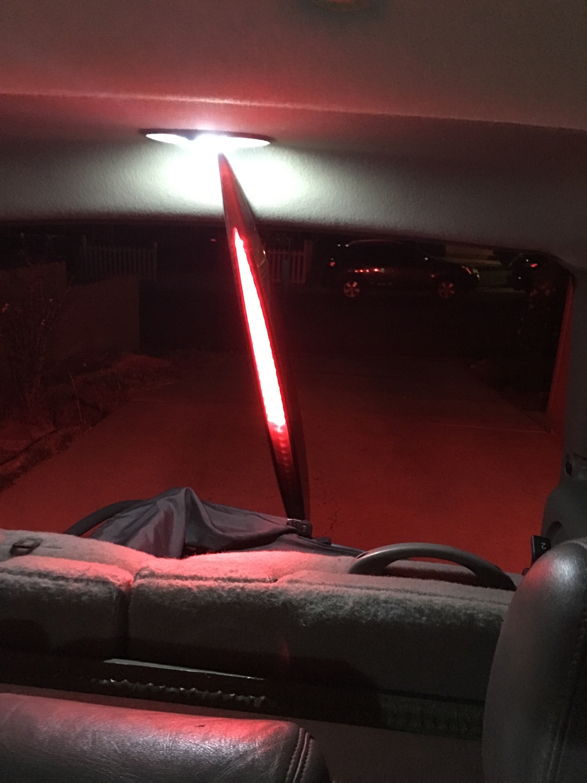

I'll be on the look out for the glass but here is an update d9177bdb747828174b18adc1bd65964c.jpgc9dc96554b18863f376bdff5c66497e3.jpg

Looks like some led's are out anyway I can repair them maybe a thread on this forum?

I checked out the LEDfix.com, seems like the way to go, you pay $219 but then get a $95 core charge when u send yours in, probably what ill have to do, the glass im going to get is in a junkyard, and has been there for a while, i didnt get a good look at it but from what i seen the light wasnt clipping into the housing on the two ends like maybe it was warped or something.

Yeah when you get the core charge back I think it works out to cost like 119. The light may not be screwed in all the way. But it also might be warped. Mine is just ever so slightly off at the ends where it sits in the base, but it's so slight that I don't really notice it.
