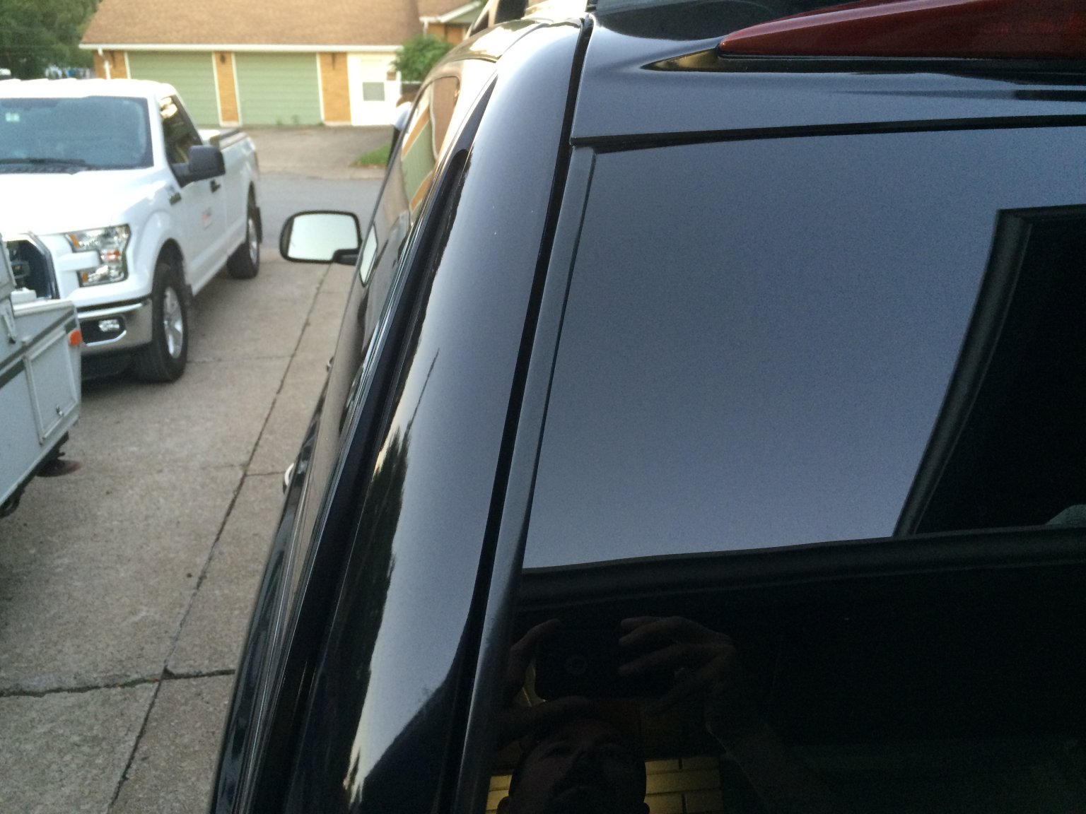

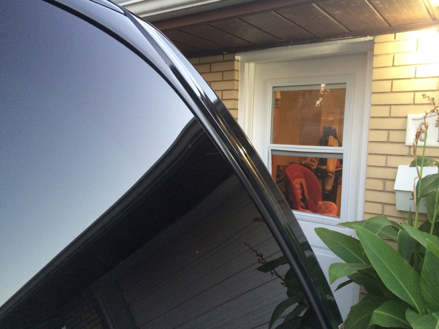

The lines match up fairly good
Side view looking back
Yea this is the esky glass

@#1taho , I don't know why everyone says there's gaps. Lol. Everything on the back end of my Denali with the eksy parts match up totally fine and there's no unusual gaps. Interesting in the wiring. I'm not sure what year esky my third light came off of. But I had to switch the wires for my 2006. Maybe the Chevy and gmc wires are different. Wouldn't see why though. Anyways your setup looks great!
Thanks. The forum had an influence :devilfinger:hahaha.
If I remember correctly is was Fosscore that gave me the idea and helped me along.
