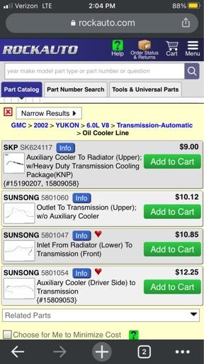

The mishimoto looks nice. It should hook up to the stock coolers in front of my radiator?
