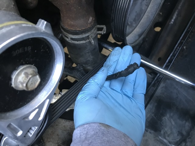

59067287-8D0B-4B0A-B871-E840B8EC72A6.jpeg 9E613CEF-6764-4F77-8E16-CD91B1D39869.jpeg Update:
Got it running roughly, stalls after a couple of minutes.
Getting these codes now.
Went to triple check ignition ground (looks like it all goes down by the crank sensor) and it snapped.
Going to repair the ground wire this evening, picked up a crank sensor also.

Yes, turns out that checking and rechecking the basics may well have saved you. When you get it going again please get a vacuum reading for another basics double check.
