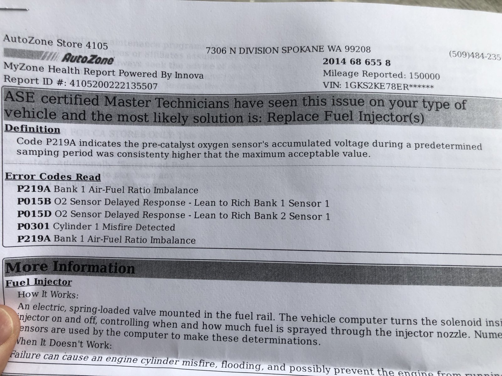

Here are the codes. Mileage is 128,***, not 150,000. I only replaced 1 O2 sensor a couple months back, the check engine light returned. I can't remember which bank I replaced at that time. I replaced with NTK/NGK O2 sensor. Looks like I need to replace some others. Probably should have replaced all 4 at the time. I appreciate any help on steps to take to diagnose and solve this problem.

The P0301 code is what I would concentrate on first. Everything else is downstream from that. Your #1 cylinder is showing a misfire and needs addressed. It could be the injector, the spark plug or the plug wire or the coil. You may also have a vacuum leak at that cylinder. How old are the plugs and wires?

Have you changed out the spark plugs or wires? They are recommended to be changed out at 100k miles, I would start there. If that does not solve the problem get the coils tested, I would not worry about the O2 sensors until you check everything upstream the O2 sensors.

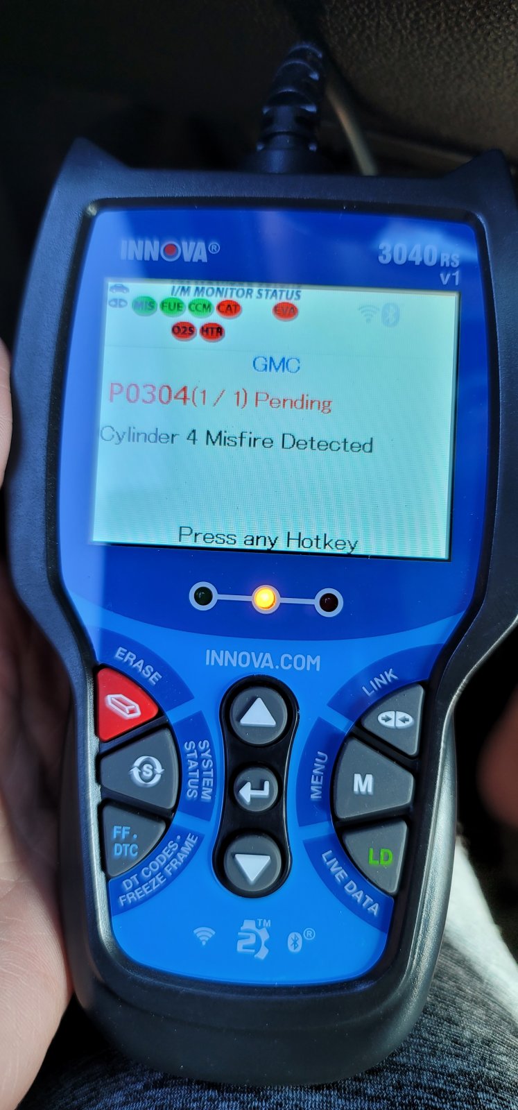

The plugs are original as far as I know, which is probably correct since we picked up the rig at 51,000 miles. What do you recommend for plugs? Iridium? Platinum? Thank you for help
