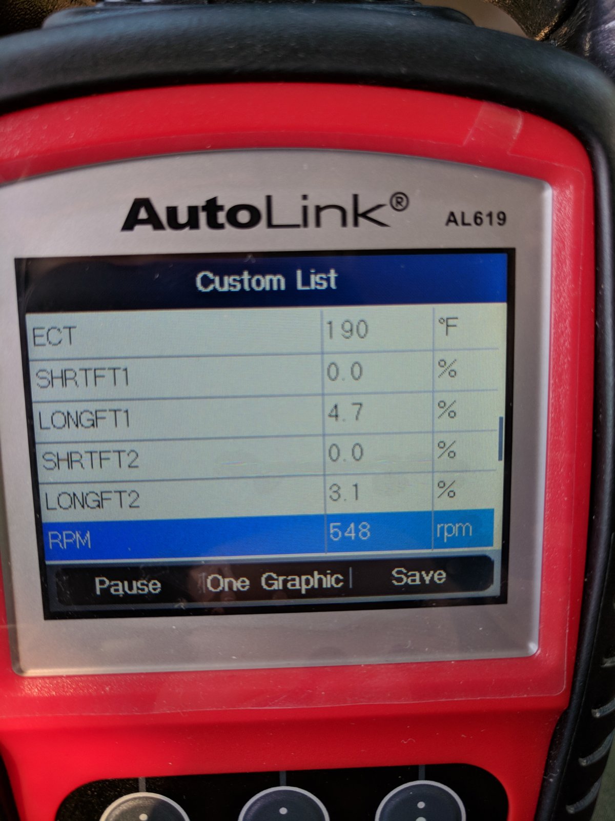

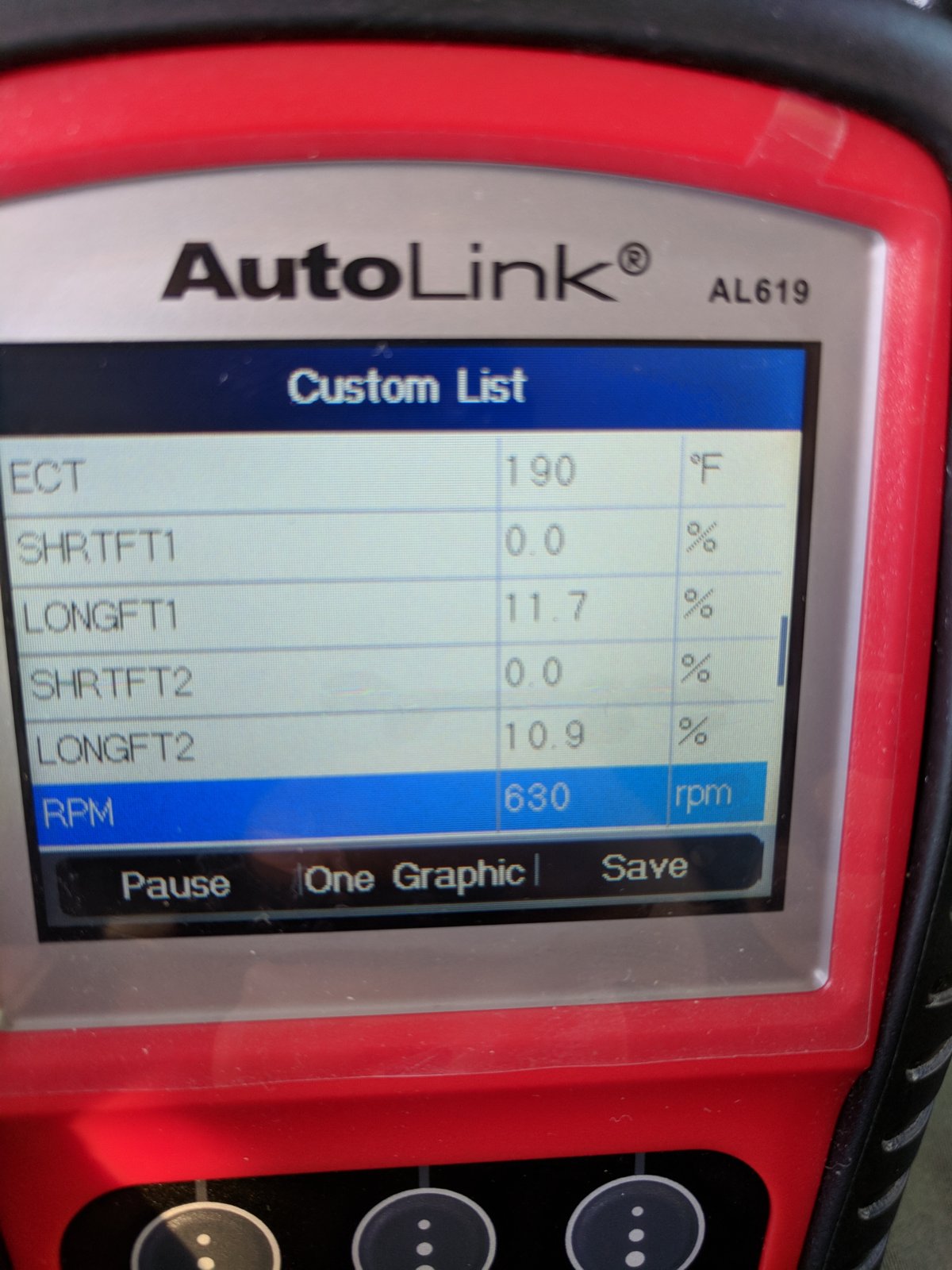

here's the pictures of the passenger side plugs. #8 plug was looseIMG_20180312_172201.jpg IMG_20180312_175104.jpg IMG_20180312_172201.jpg IMG_20180312_175104.jpg IMG_20180312_173631.jpg IMG_20180312_175104.jpg

yup, those look like its running lean.
see any missing manifold bolts? the back one likes to break off or just come loose and fall out. had both happen in the past.
the hoe i just got has that back pass side bolt broke or missing. ill fix that when i install my headers.

I think I noticed 2 missing on the passenger side I wasn't sure
