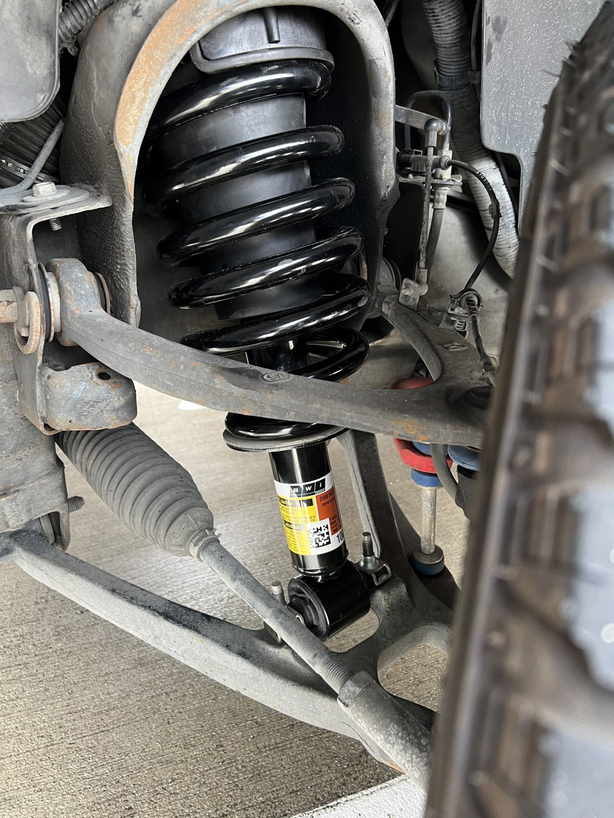

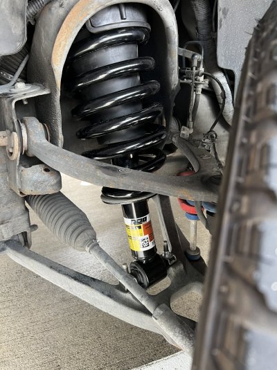

On a side note I ended up buying all the parts for a complete new coil over strut. With 130k on the clock (I’m original owner but still lot of miles) figured I’d go ahead and buy all new springs, strut mount, bumpers, insulators spring seat and hardware. Wasn’t too bad getting all parts but double check your oem strut mount and spring seat part #’s. The had the wrong spring seat part listed thru gm even with vin search.

I replaced all of the front suspension components as well, including the upper and lower control arms and ball joints. I figured that while I was into it, I might as well replace everything, and then I don't need to worry about it for the next 100k miles.

Posting this as it may help someone
If your replacing the strut mounts and it’s GM part# 25940743 (I got mine on Amazon for 22.00 aftermarket part)
the correct and matching spring seat is part# 25940742 or 84061243 (same part)
I had multiple GM part suppliers try to tell me it was #15803177 which does not fit the above strut mount.
Also the correct top nut part# for my 2011 Yukon Denali (Z55 6ya,7ya) is
Gm part# 15815577
Hope that helps others!

Let us know in about 6-12 months how the top strut mounts from Febest Parts work out.

I don’t expect an issue based on inspection- stamped metal part correctly lines up with everything else. Worse case I pay 45 bucks for the ac delco version and flip it out.
If you have experience or something to share just be str8 up so others can hear as well and make their decision.
