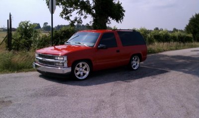

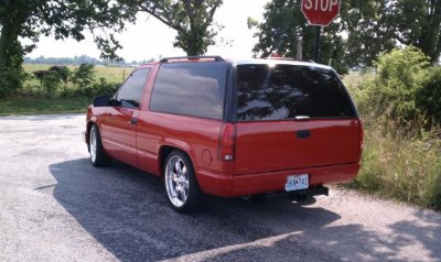

My rear fenders aren't rolled, but it is actually rubbing at times on the inside towards the rear of the wheel well. I thought about rolling my fender lip and adding a spacer to my wheel to space it out a little bit. I believe I am setting at a 5/7 drop, I thought about lifting it a little, but it looks pretty damn good right now.

"Looks good" damn dude, that looks bad ass.
What size wheel/tire combo do you have?
I need to figure out what I'm going to do with my Hoe. Thats a little incouragement right there.

+1 to looking damn good.. The flip kits usually put the truck over the expected drop. Id deff lift it up a hair.
Do you have your stock shackles in place? on my truck, i had stock shackles, now im going to a 1inch lifting shackle to get away from any rubbing, plus it looks better to match the front. seems like your ass is a little down compared to the front in the picture..
(need to remove the rear wiper, paint the pillars glossy black, and dome debadging :)) haha
heres my truck without the lifting shackle..
As you can see, with that flipkit it just sitstoo low in the back. parts should be here this week
