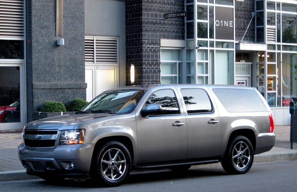

I have the relocators on the front set at 1.5 inches and it rides excellent.
Also. You may get MORE than a one inch drop set at 1 inch.
For example, I set my mcgaughys reloactors at 1.5 inches, and it ended up sitting 2 inches lower.
So if you set yours at 1 inch with both steel rings in, you may be at a 1.3 inch drop........... or so.

BTW, your truck looks great, man! As it sits in that pic, its down 2" in the front via the relocators and also 2" out back with the BellTech springs and bags, right? And I'm still undecided on shaving the side moldings and emblems. Some pics I think its too plain looking and others I think its just right. Tough decision on that one! :hmmm2:
Thank you :)
2/1.5
