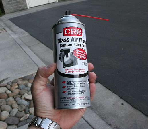

youll be good with plugs n wires. the 4.8 5.3 6.0 dont have cap n rotor. just plugs wires n coils
if you did wanna take it a step further change the fuel filter, pcv, n clean the mass air flow sensor

at autozone get MAF sensor cleaner....DO NOT USE contact cleaner...its 3.99 for a can of MAF cleaner and it will save you from ruining the sensor and then pulling the check book out to get a new one...and when you pull the sensor off be very careful you do not touch the internal wires...also if your getting a CAI and you have an oiled filter you will prob have a check engine light come on after a little bit cuz the oil fouls the MAF and you'll have to clean it again...just happened to me...i cant remember the code it throws but it translates to banks 1&2 running lean...hope that helps
