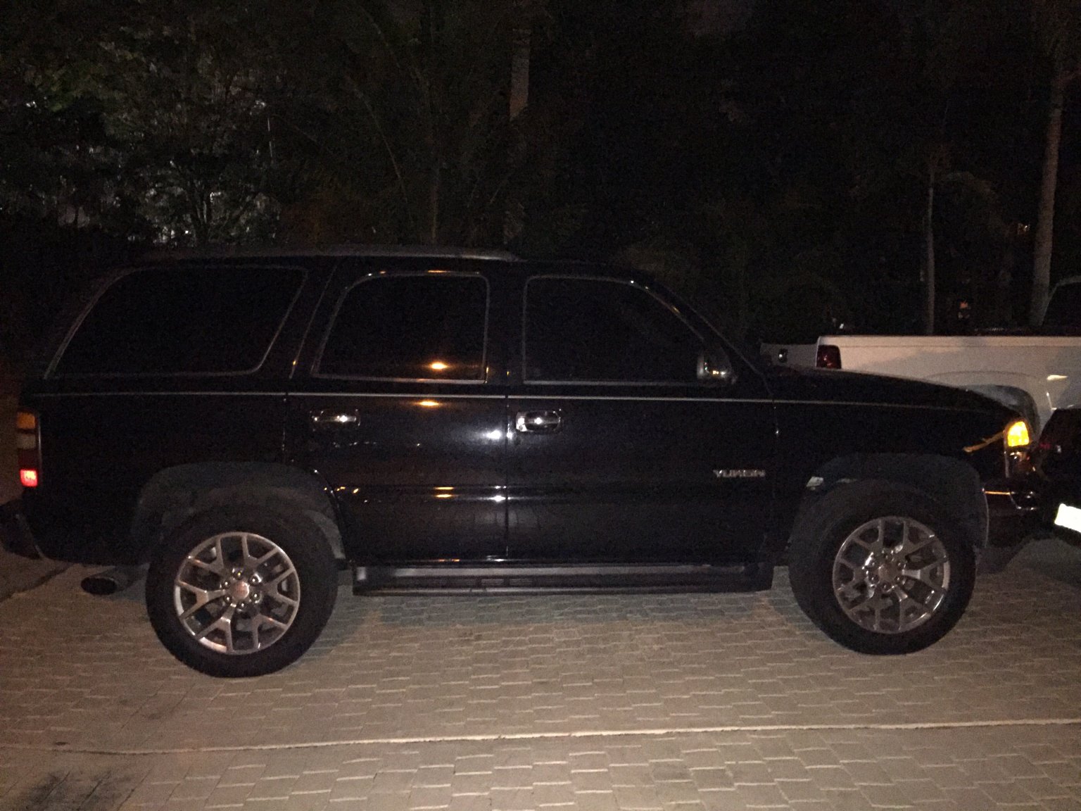

SnookHero
Dec 30, 2016
Can't believe i got no responses... but i put the z71 springs in and they are awesome. Cranked the torsion bars 5 turns and the front came up. Rides great now. So much fun to drive now that i dont have to fear railroad tracks

Looks good. For comparison, do you have any pics of how it was when you bought it?
But, if you wanted to see what a stock Yukon with Z71 springs looked like, you could just Google something like "2002 Yukon Z71".
